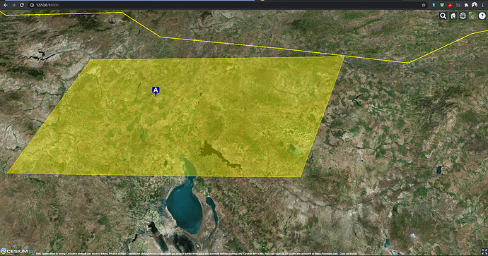

Hello. I used django-geodjango to provide geo asset management and created tables for asses. Then I linked them to my database and cesium. When I create geo-assets from the django admin panel, I can show them automatically thanks to the cesium gejson feature (you can see it in the screenshot). Is it possible to create geo-asset and save it in my database by clicking on the map over cesium without entering the django admin panel?
