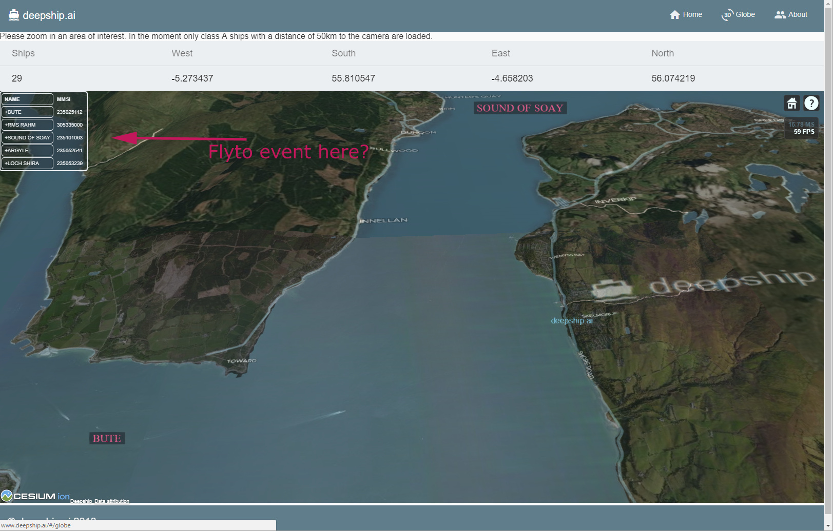

1. A concise explanation of the problem you’re experiencing.
Under http://www.deepship.ai/#/home I have leafet listmarkers installed and a flyto event.
Under http://www.deepship.ai/#/globe
I have a 3D setup where i installed a server side event script that streams czml data to all targets that are 50 km from the camera.
This also updates a list of ships which is updated once a second.
Nevertheless I can not figure out how to get a flyto context in the DOM domain of Cesium or anything similar to the homebutton event.

The update function generates the html every. The specifics are a bit of a left over from various attempts. Here one with knock out.
forceUpdate() {
var mytext += ‘
NAME MMSI ’;
this.textnode.innerHTML = mytext;
for (var j = 0; j < this.viewer.dataSources._dataSources[0]._entityCollection._entities.length; ++j) {
if (j < 20) {
mytext += ’
’ + this.viewer.dataSources._dataSources[0]._entityCollection._entities._array[j]._name + ‘ ’ + this.viewer.dataSources._dataSources[0]._entityCollection._entities._array[j]._id + ‘ ’;
Knockout succeeds when I add an element static. But dynamic I can not get anything out of the the inputs, buttons and so on.

Cesium.Camera.prototype.flyTo(dest)
I saw the home button in Cesium is linked to data-bind:click:command. But I don’t know what command is or how to access this. Any similar attempts failed on my side in my dynamically generated list.
3. Context. Why do you need to do this? We might know a better way to accomplish your goal.
I essentially just want any way to dynamically generate a fly to button to an dynamically generated entity in a list like Leaflet.listmarkers.

Hi,
It would be better to create an Angular component for the dynamically generated HTML and append that to the innerHTML of the textnode. That way you would have more control over its content and could add a (click) event on each button and invoke flyTo command.
