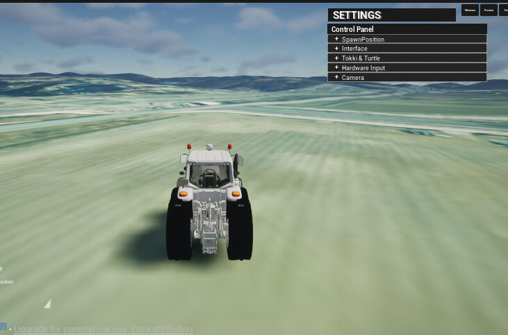

I’m using Unreal Engine 5.6 on an Apple M1 Pro environment. When I build the project in Development, Cesium loads correctly, but in Shipping Build, Cesium fails to load. I’ve already tried adding the StarfieldServicesRootCertificateAuthorityG2.pem to the Mac System Keychain as suggested in the forum, but the issue still persists. If anyone on macOS has experienced the same problem, could you please help me?

Hi @skendy209, welcome to the community!
I’m not sure what might cause that problem. Are the builds running on the same system in both cases? Are they stored in the same location as well? (i.e., if one were stored locally and the other on a network drive, that could be an important difference)
Probably the first thing is to check the Unreal logs for any hint. You should be able to find them in your built project’s directory under [Project Name]/Saved/Logs.

Both builds are running on the same system (Apple M1 Pro), and they’re stored in the same location — the project is stored locally.
The following log output is from the Development Build, captured via stdout.
(I’m still trying to find a way to generate log files for the Shipping Build — with my current setup, I haven’t been able to extract any logs yet.
If you could explain how to enable or extract logs in the Shipping Build, I’d really appreciate it!)
In the log, there are the following lines:
Image not of any known type, or corrupt
Image url: https://api.vworld.kr/req/wmts/1.0.0/51A97A7F-507C-35D2-9AC0-72148E8D30E4/Satellite/3/4/5.jpeg
Could this part be causing problems in the Shipping Build?
I also tried including the Cesium for Unreal source code directly into the project and attempted the Shipping Build again — including the Starfield certificate — but the results were the same.
CustomLogfile.zip (33.1 KB)
Did you check the Saved directory in the built project output directory? With the Cesium for Unreal Samples project, logs are stored there, even in Shipping builds. I don’t think we did anything special to make that happen.
That image error is strange (it suggest a broken jpeg, or at least one that Cesium for Unreal is unable to decode for some reason), but I don’t think it would cause the Shipping built not to work at all.

The reason that tileset don’t work in Shipping builds on macOS is because, by default, the “entitlements” file used by Unreal Engine disallows network access in shipping builds. More details here:
