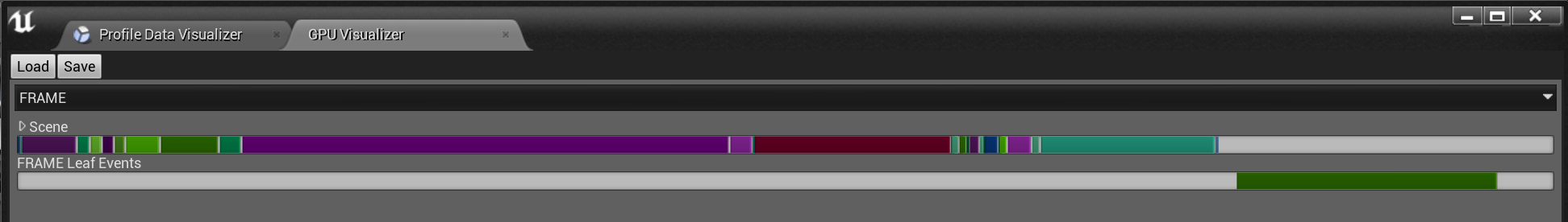

You can bring up something called the GPU visualizer by pressing CTRL+SHIFT+,
you can click on any of those boxes and it’ll show you what it taking longer to render. This will also help you see if the GPU is what is slowing things down, or if it’s something else.
This takes a snapshot of a single frame and it lets you see how many milliseconds each thing took to calculate. This also means that you can go somewhere else, bring it up again, and you’ll get different results.
