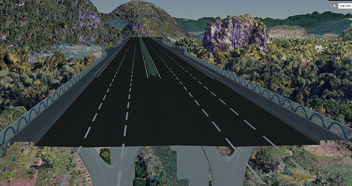

Does anyone know what caused it? How to solve it?
This looks like the near plane is clipping the tileset.
Try either:
viewer.camera.frustum.near = 0.2; // It’s 1 by default. Smaller values cause less clipping near camera
Or disabling logarithmic depth (https://cesiumjs.org/Cesium/Build/Documentation/Scene.html#logarithmicDepthBuffer):
viewer.scene.logarithmicDepthBuffer = false;
Let me know which of these fixes it (or if neither does).
Disabling logarithmic depth works. Thank you very much for your answer.
