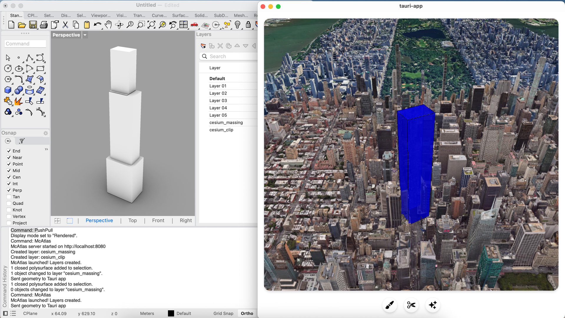

It is a Rhino plugin so users can visualise their 3D Architectural or Masterplan models in Cesium.

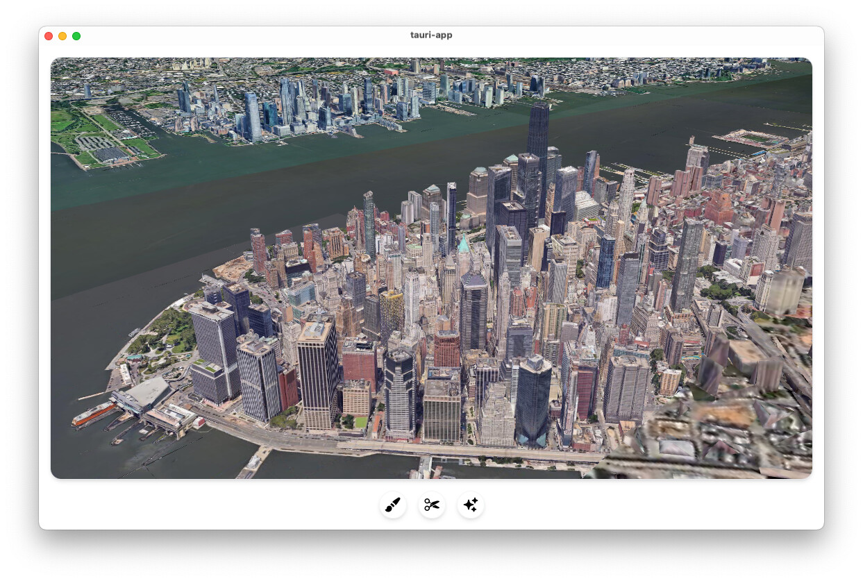

The way it currently works… I have Tauri app with Cesium 3D realistic tiles.
My Rhino plugin starts the Tauri app and creates special layers.
I am using http simple server for communication between the two.
I currently managed to transfer a bounding box from Rhino to Cesium.
But can’t find a clean way to transfer a full geometry programatically? I think I need to find a way to provide glTF model?

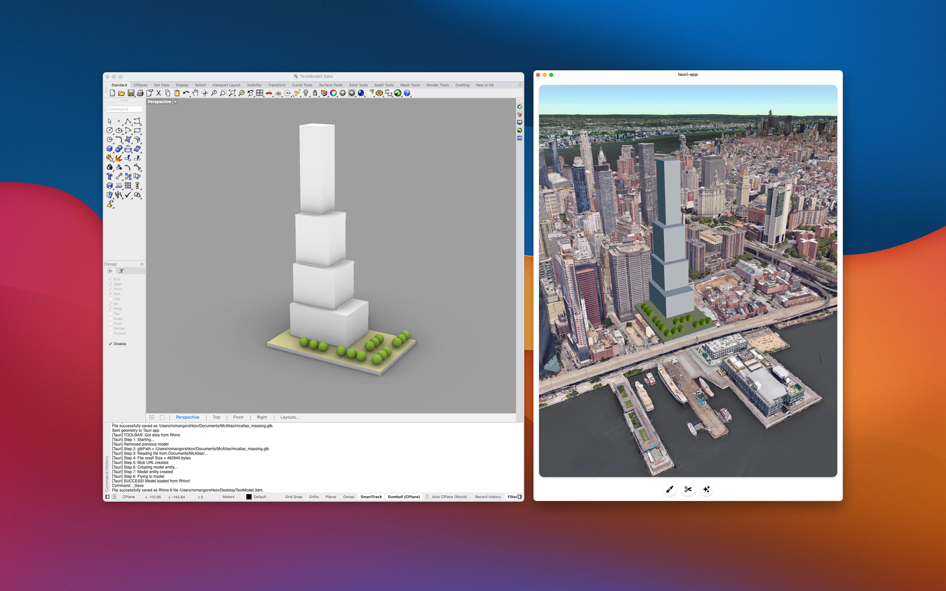

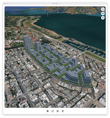

Thank you @mzschwartz5
Spent a few days but got it to work!
One more thing to make imported model look better like part of the environment. Shadows, reflections, AO etc.
I managed to add AO, but maybe you have some ideas or pointers I can look into ?
Nice, that looks really cool! Given that the rest of the environment appears to not really have shadows (except those baked into the imagery), I’d say the most important aspect that would help blend the model in would be a texture map to give it some building-like facade.

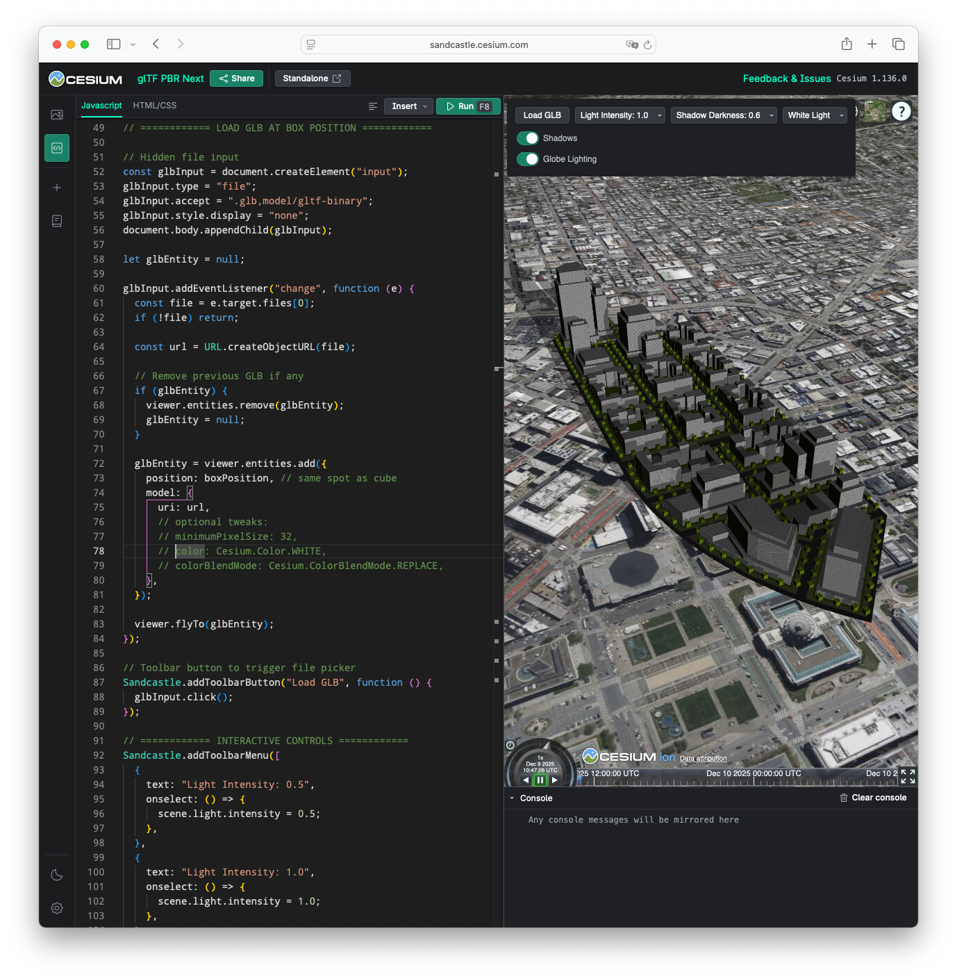

Hi @mzschwartz5
Thanks for your help. I think I managed to do lot of progress. I can sync models between Rhino and Cesium. All geolocated as well.
But I have problem with PBR Materials. I export GLB including PBR materials applied in Rhino.
Supposed to be just simple white, but Cesium renders them dark grey, it almost like it applies sone stage tone mapping or post processing?
I thought something wrong with my GLB, but I opened it in Blender and all materials are fine.
I created a test Sandcastle so you can see a problem.
mcatlas_massing.glb (4.9 MB)
