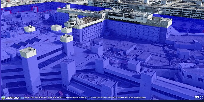

I’m trying to draw a polygon on top of a 3D tile.
This is very close, the only issue is that no matter what I do I can’t have a thin polygon on ground level.
If I make it thin without setting heightReferences it just hovers
If I do set them, i can’t get the thin layer I want.
This is the code I’m using:

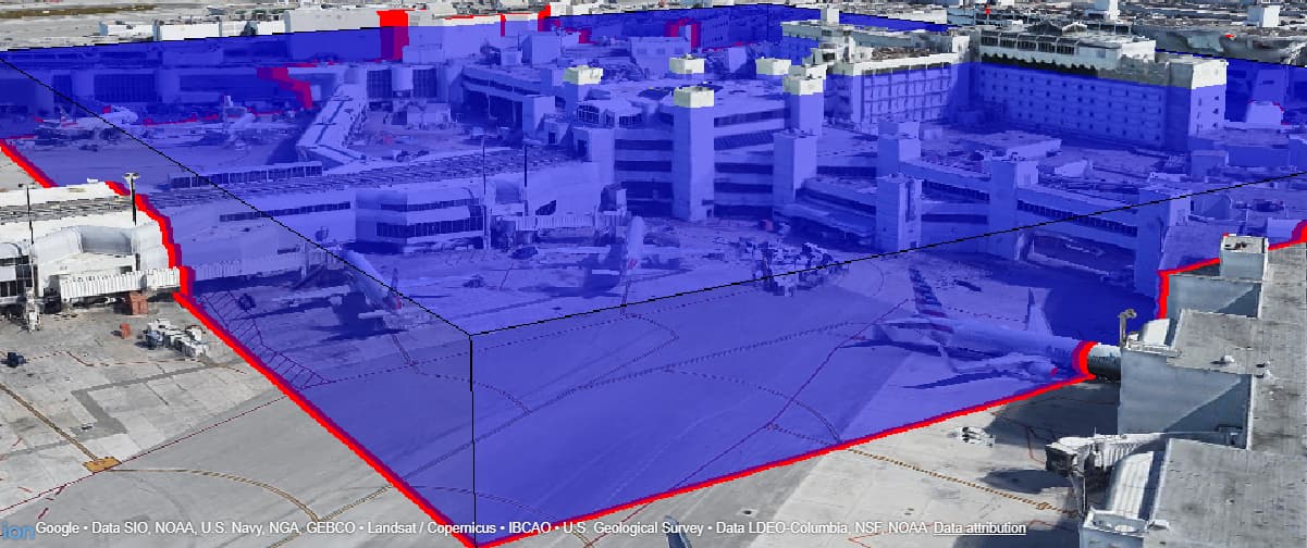

For reference I’d really need something at least half this height:
and ideally the ability to set arbitrary heights respecting the 3D tile structure heights.
