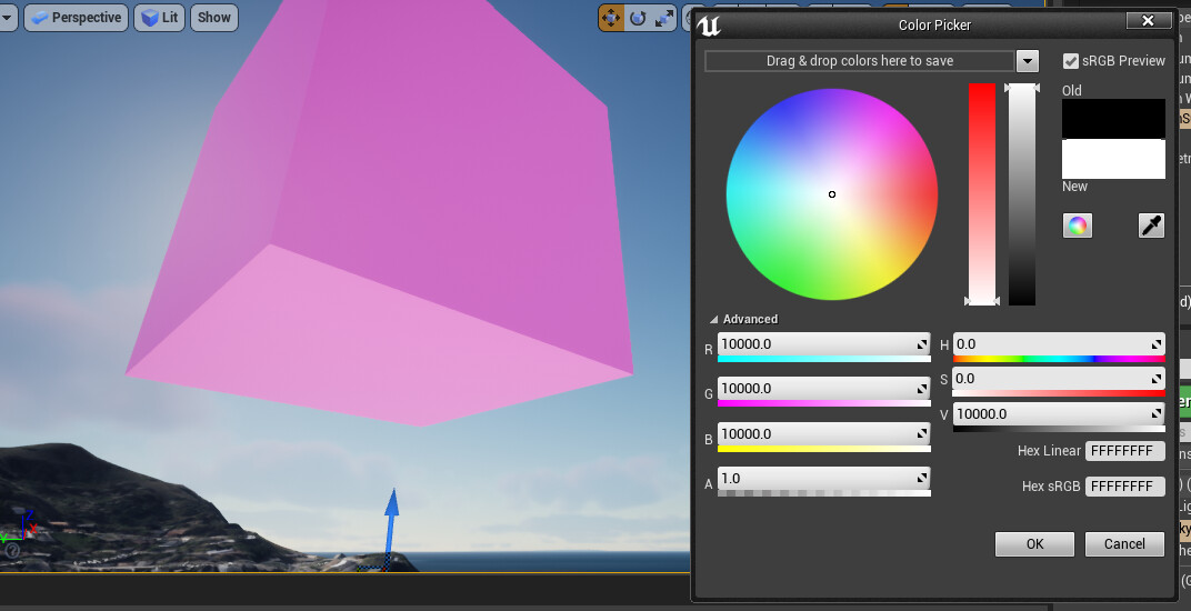

Hi @zidekk2,
I believe this is caused by the relative light levels in the environment. CesiumSunSky’s directional light is very bright, and a flat white color doesn’t have much of an effect. In the color picker panel, try setting the V value to something very high, like 10000 (You’ll have to type it in, the slider won’t go that high.) Doing so should give you light undersides.
