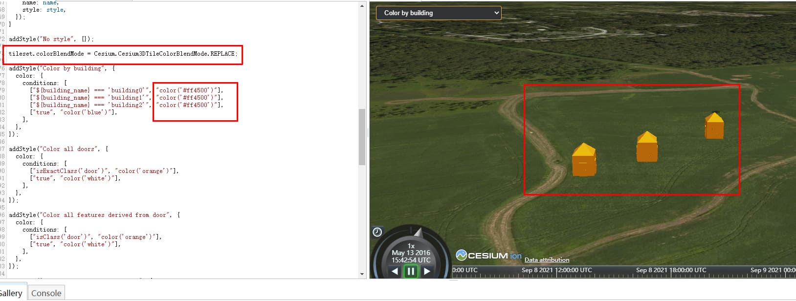

in this demo,
the changed:
tileset.colorBlendMode = Cesium.Cesium3DTileColorBlendMode.REPLACE;
addStyle(“Color by building”, {
color: {
conditions: [
[“${building_name} === ‘building0’”, “color(‘#ff4500’)”],
[“${building_name} === ‘building1’”, “color(‘#ff4500’)”],
[“${building_name} === ‘building2’”, “color(‘#ff4500’)”],
[“true”, “color(‘blue’)”],

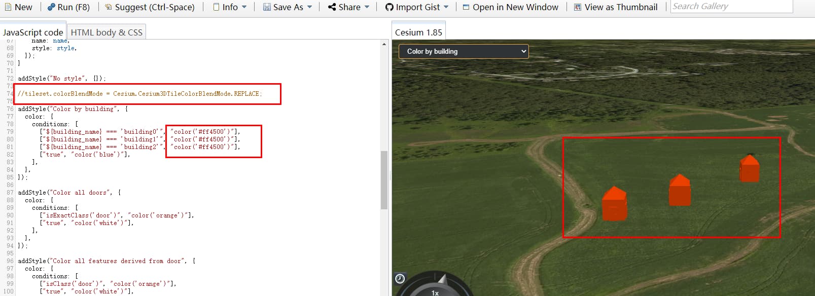

if not set tileset.colorBlendMode = Cesium.Cesium3DTileColorBlendMode.REPLACE;
the color is looked like right, but set replace, the color near yellow(?)
but not set tileset.colorBlendMode,(HIGHTLIGHT), when set color to model that already has some color, it ,en ,not right

use #ff4500, this color is near red,but when set REPLACE, it orange
color: {
conditions: [
