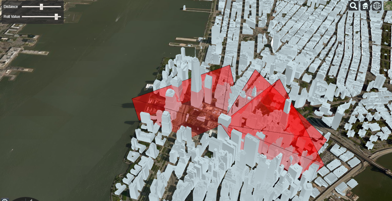

I am working on frustum functionality, where I was trying to change angle distance, head, and pitch dynamically.
But when I was drawing with 30 degrees initially and later changed to 60 degrees,but the first frustum view of 30 degree has to be disabled where i couldnot find any syntax to disable.

Hi Gabby,
I have taken frustum code from github link below.
https://github.com/AnalyticalGraphicsInc/cesium/blob/master/Apps/Sandcastle/gallery/development/Frustum.html
i have modified by adding distance and
rolling_value
& changing dynamically frustum view.

based on changes of each distance and rolling value , multiple frustums is created. i just want to disable previous frustum view while changing dynamically then i can show only current view.
Please help me how can i disable frustum .

Hi Omar ,
Thanks Gabby , we have worked with camera.frustum property to show the dynamic frustum view.
Yes am creating a new one every time based on dynamic distance and rolling value . I think CallbackProperty cannot be able to help here. please guide me .
below is the attached html and snapshot for reference.
