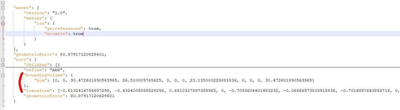

I’m using tilers from the enterprise package that Cesium offers. Tiling an asset (file) gives me a cesium 3dtiles dataset, as expected.
What I’de like to do is extracting bounding volume and center in WGS84 coordinates from the generated tileset.
When browsing 3dtiles specification I find that every node has a bouding volume (box in my case) matrix and a transform matrix. https://docs.opengeospatial.org/cs/18-053r2/18-053r2.html
My guess is that it should be possible with some calculations between those 2 matrices to obtain WGS84 coordinates about the center and region of the tileset.

P.S. :here is the location of these matrices in tileset.json files :
tileset.json (6.29 KB)
