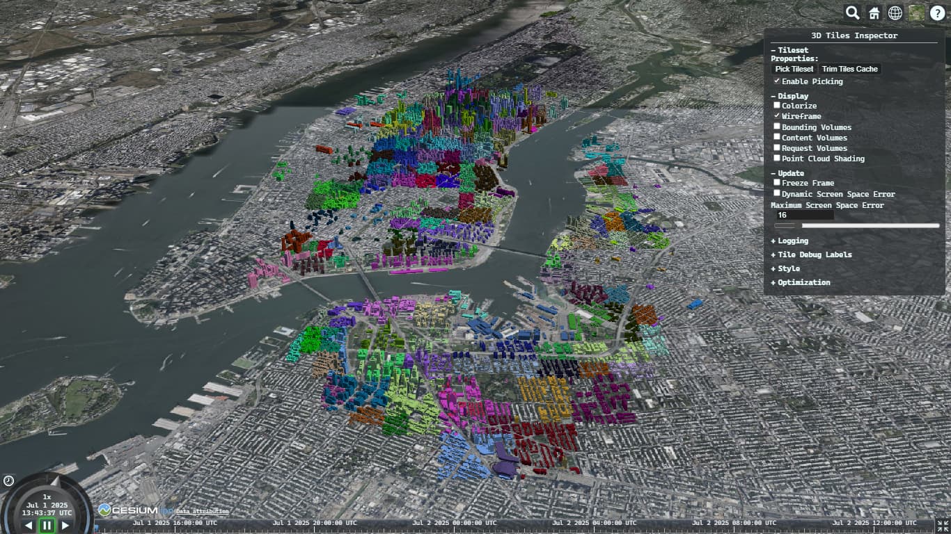

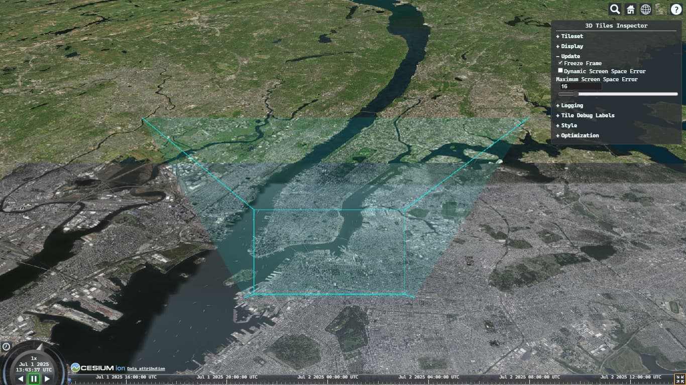

make sure tiles are correctly loaded for points for which you want to sample the height.
to simply check this execute the the process and when you get the result back go to properties of the cesium3dtileset actor and freez the updates. zoomout a little bit and you will see if tiles where you want to sample the height is loaded or not.
pictures are just to put point across you will find simillar option in the unreal engine.
I hope this helps.
We cannot sample height for the points when the Tileset is freeze(suspend update is true). I tried zooming out, the tiles were loaded in that area but sampling in failing consistently on some specific points.
