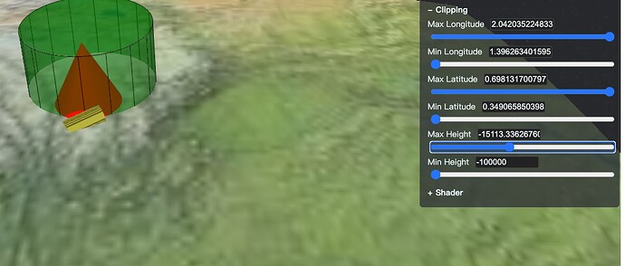

Here’s the voxels I drew and some geometry, cropping the voxels to different heights, the geometry is all the same, there is no occlusion
My objective is to achieve voxel occlusion of other geometries.
