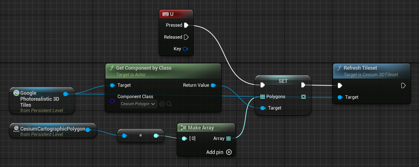

Hi @V2i ,
I haven’t been able to reproduce this so far. I tried using this Level Blueprint and creating a packaged build (DebugGame configuration). After I press U and zoom in close, I don’t see any memory errors.
There are a lot of variables here, though. Can you give me detailed step-by-step instructions for reproducing this, preferably starting with the Cesium for Unreal Samples project?

Hi @Kevin_Ring ,
I have been able to replicate this crash in the CesiumForUnrealSamples Project. Just from observations, it looks like as it tries to refine the lowest level of a partial clipped tile is when the crash occurs. It can also be induced if you rapidly add/remove the polygon (within 10 seconds or so)
I’m having a really hard time tracking this crash as it often crashes so hard that the error reporter doesn’t launch to provide a crash log as you can see in the video. I have yet to get the crash to occur in PIE, only Standalone preview or pacakged build.
Here is the video of the crash in the packaged build: https://youtu.be/OLcIKSBjtMA
Here is the setup to replicate with the level blueprint. I am using the level 12_CesiumGoogleMapsTiles:

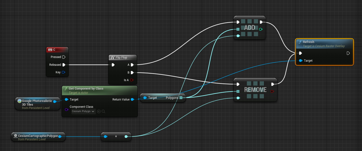

Hi @Kevin_Ring ,
Just an FYI, I have tested using CesiumForUnreal 2.20.0 and the crash now is very repeatable to a much wider extent. It now happens reliably for all tilesets not just the Google Photorealistic Tiles. As the others have found, using plugin v2.17 this crash does not occur.
Here is a video showing the crash in packaged build from CesiumForUnrealSample project using the 08_CesiumClipping level: https://youtu.be/GUbric4svTo
Here is the blueprint setup for testing in the Level Blueprint: Clipping Cesium Crash Example posted by anonymous | blueprintUE | PasteBin For Unreal Engine

The crash now happens consistently whenever a polygon shape is added or removed and refreshed in v2.20. I haven’t been able to scope further into it than this.
Interesting note is that the crash happens every time in a a packaged build but rarely in PIE or standalone.
