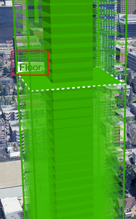

Hi everyone,
I am facing an issue with the cesium label entity. We are working with polygon entities. If user clicks on the polygon, the label of the polygon shows on the polygon. But the issue is, the label is hidden inside the polygon. I have used disableDepthTestDistance: Number.POSITIVE_INFINITY, but does not work.
I have attached a screenshot.
I will appreciate your help. Thank you.
Hi @Masum_Billah,
I believe this is a manifestation of this bug, which is a regression introduced in CesiumJS 1.135. A fix has been merged and will be released next week as part of version 1.136.
Please try out your example on either 1.134, or with 1.136 when it’s released (or you can build it yourself from source now), and see if that solves your issue!
