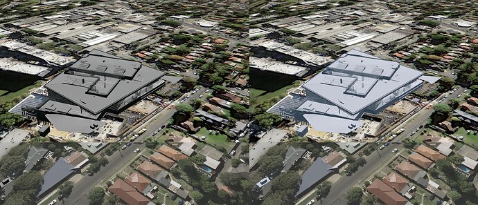

Was there a resolution to this issue? I encountered it in a simple JS test app I’m writing.
Left is the first viewer, right is the second.
There must be a race condition as this code has problems
    viewerA.scene.primitives.add(leftTileset);
    viewerB.scene.primitives.add(rightTileset);
    viewerA.zoomTo(leftTileset);
    viewerB.zoomTo(rightTileset);
Where this code is generally okay, though if the timeout is too small, sometimes both viewports will appear with darker lighting
    setTimeout(() => {
    }, 500);
