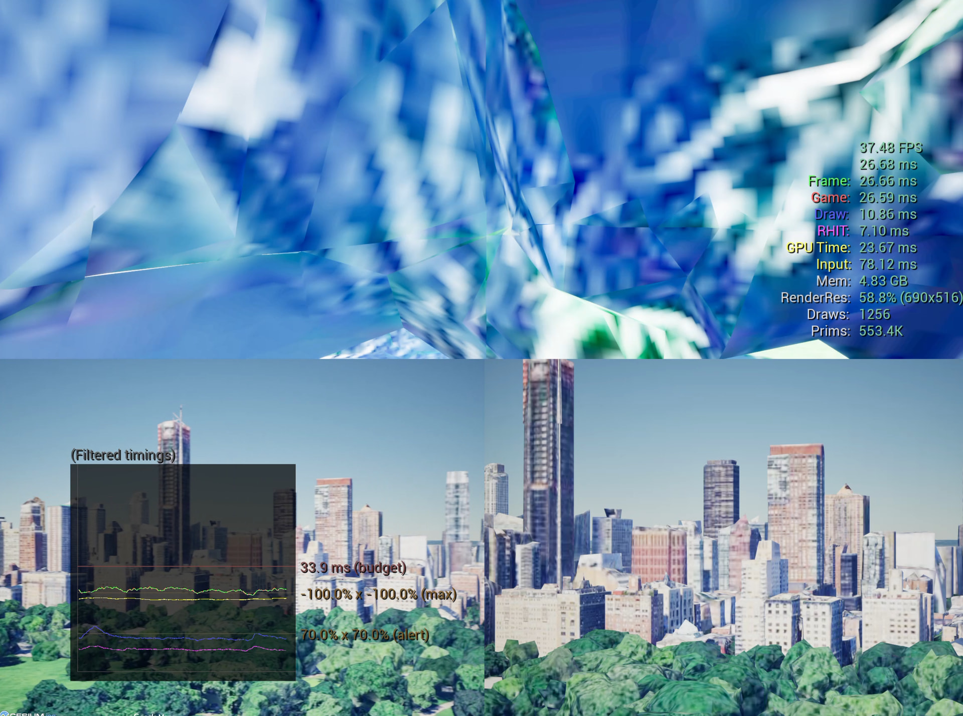

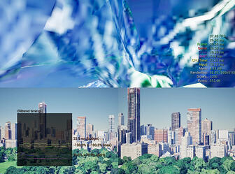

@Ben i tried updating my UE version to 5.7.4 and cesium plugin to 2.24.1 but the same issue persists, i have attached a video link showing the main player camera and secondary camera registered via camera manager, both are situated at same place looking at different directions but the FPS drop is still there upon zooming.Video Link
Thank you both, the recording helps a lot. I’ve opened an issue here → Multiple registered cameras performance issue · Issue #1823 · CesiumGS/cesium-unreal · GitHub
