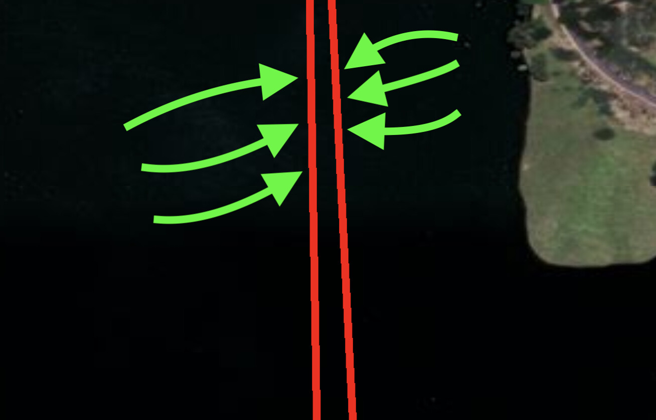

I see Polyline rendered in an unexpected pixelated manner if clampToGround: false:
The Polyline has even width (closer to what would be expected) when clampToGround: true.
Is there any way to make the Polyline antialiased in pixel-perfectly smooth way?
The rendered lines are a bit like sawtooth shaped:
Thank you!
Sandcastle🏰
Thanks for the report @m.rykov!
I believe this is the same issue as PolylineGeometry 2D rendering incorrectly at certain zoom levels · Issue #5726 · CesiumGS/cesium · GitHub. Do any of the workaround work for you?
We have implemented two anti-aliasing solutions, FXAA and MSAA, but unfortunately neither will apply to the polyline use case here. There’s a feature request for that use case here.
