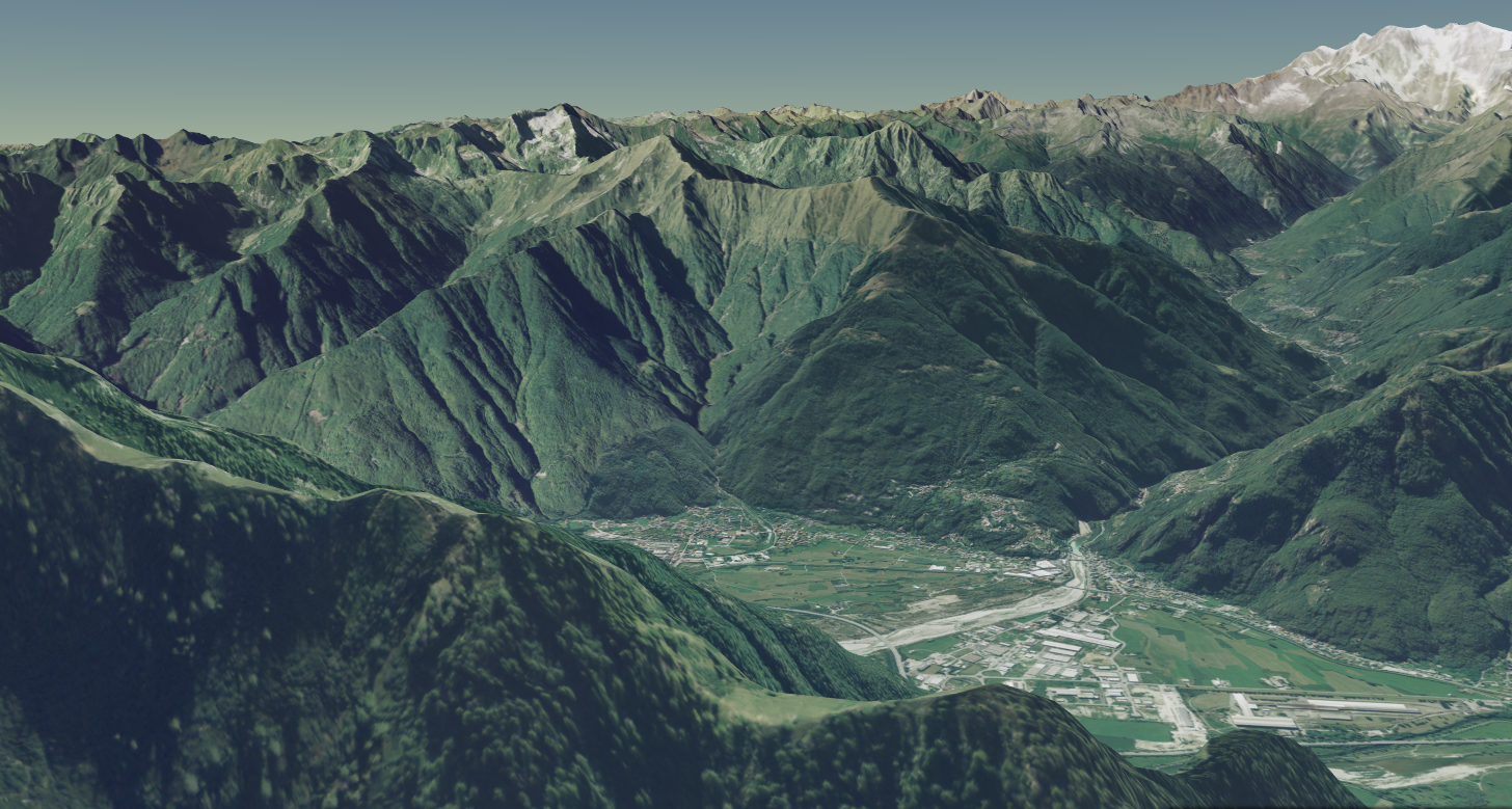

Hi, I’ve implemented a tool to convert folders of ASC and other DTMs to quantized-mesh format.
I’ve used Miniball to calculate the minimum bounding sphere (http://software.icecube.wisc.edu/icerec_trunk/doxygen/phys-services/Miniball_8h_source.html)
The results obtained are more than satisfactory.
Here is a screenshot: http://www.daigio.it/qmeshsample.png
