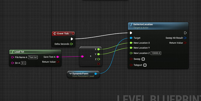

If the Z axis of the camera exceeds 10000 through the blueprint, the camera will fly up all the time. What is the problem and how to solve it.
Hi @youtoom,
On your Georeference actor, is Keep World Origin Near Camera enabled? It’s possible the origin is being rebased, and that might be causing some problems with your blueprint.
