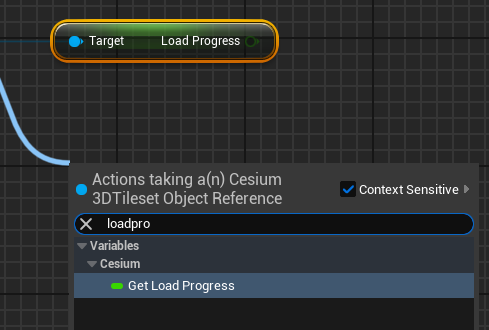

Im unable to find a " Compute Load Progress function. It’s not in my 3dTilesSet or actor I’ve searched for. I’m using “Cesium for Unreal 5.5.0.”
Where do I find this function?
Hi @ReggieStantec,
Sorry for the confusion. It should actually be called Get Load Progress.
