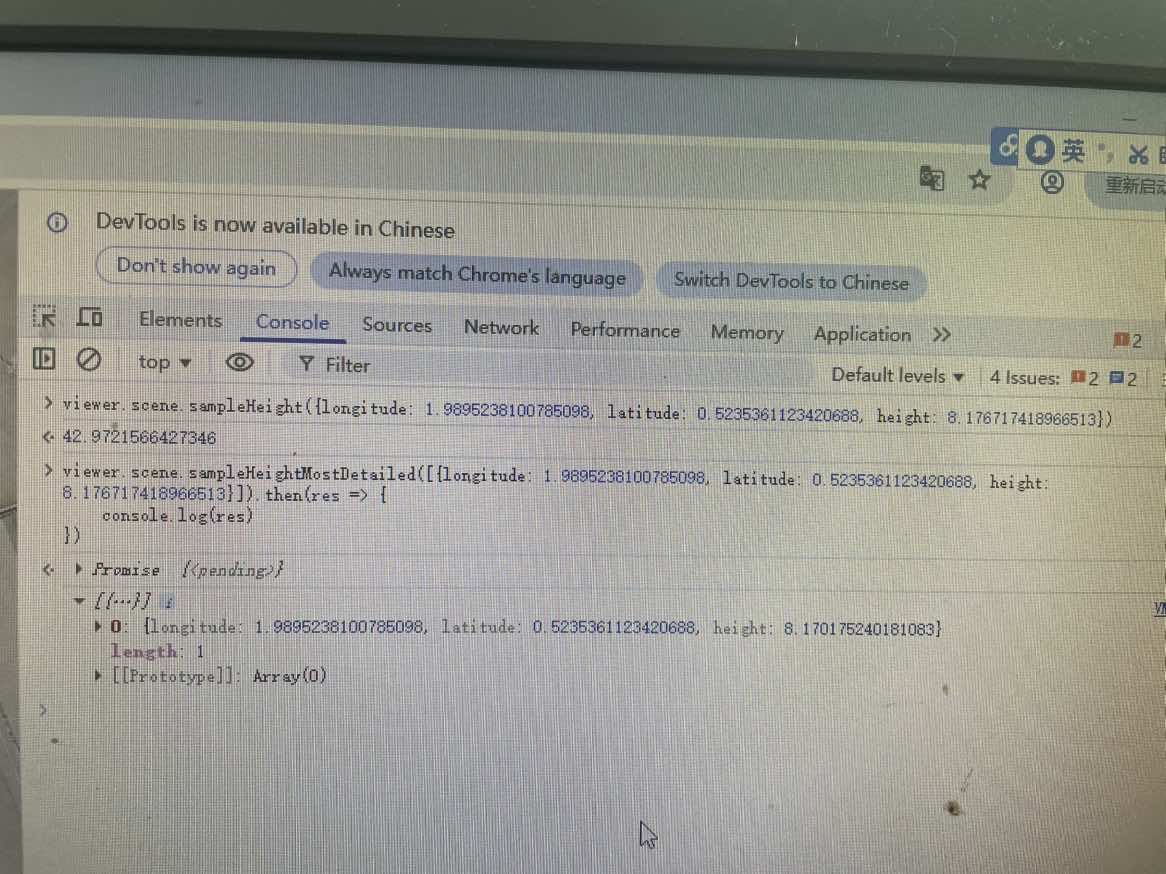

The heights returned by scene.sampleHeight and scene.sampleHeightMostDetailed are different
I added a 3D Tileset model at this location, and when I used these two methods to get the model’s height at the same coordinate point, the two methods returned different heights.

This is the expected behavior. (If both functions returned the same value, then it wouldn’t be necessary two have two functions, for what it’s worth).
Assuming some familiarity with the concept of “Level Of Detail” in 3D Tiles (and in general):
The sampleHeight function computes the height based on the representation of the terrain that is currently rendered.
The sampleHeightMostDetailed computes the height based on the most detailed representation of the terrain that is available. (Hence the name…). This means that this function may internally make additional web requests to load the most detailed data that is available for the given point.
A crude attempt to illustrate where the different heights are coming from:
The “most detailed” height may be slightly smaller or larger than the “simple” height. The magnitude of the difference should depend on (or be limited by) the “geometric error” of the tile, but that’s not something that can be taken for granted.
