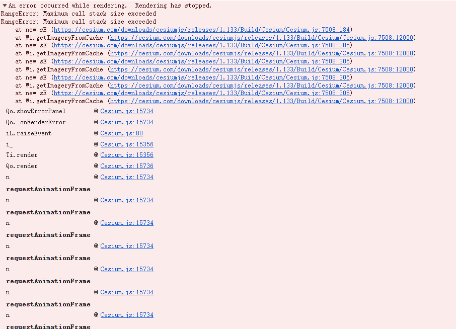

Thank you for your reply.You are right, I can indeed run your example test, but as long as I use the layers on my own server to do it, there will be an error. Sorry, I am unable to add test cases. This is my error message:
The error is from cesium/packages/engine/Source/Scene/ImageryLayer.js at 4b77c39685fa2c25ba5f7b8a2e703c714f9c8528 ¡ CesiumGS/cesium ¡ GitHub
What is the number of “levels” that this server claims to support?
(I could try to type the URL from the screenshot, but… don’t see a reason to spend time with that…)
I have encountered a similar problem and solved it by modifying the ‘maximumCachedTiles’ parameter and ‘maximumLevel’ parameter. And I encountered another problem:when I add multiple imageryLayers to 3dtiles, there is a warning: ‘Draped imagery requires 12 texture units, truncating’.

This might be a hint that the server is returning a wrong (or at least an unreasonably high) number of tile levels. (This should be independent of the draping, though - I’d expext the same error to happen when this imagery is draped on terrain).
