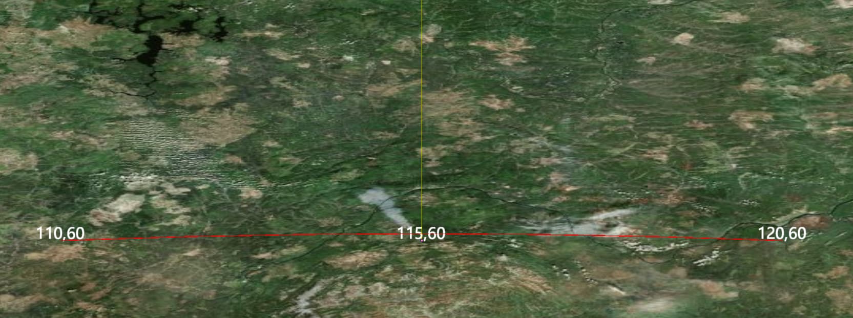

Draw a line through two points, Draw another line through two points. Theoretically one vertex on one line should lie on another line. But the actual display is not. May I ask why this is?

Thanks for your answer me. but I have a another question.
The clampToGround of the red line is true,so I think the coordinates of the line is on the sphere surface.
And so is the other line.
In the same mode, I think their coordinates are the same. Could you explain it in more detail?
