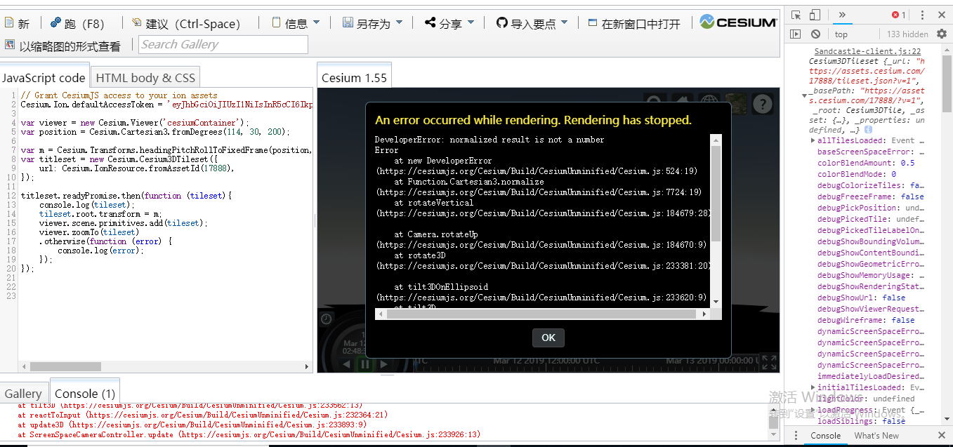

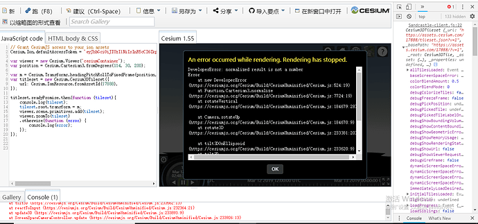

When I use the Cesium example to load point cloud data, a normalized error occurs during mouse operation.
Later I found the OrientedBoundingBox.distanceSquaredTo method, if box.halfAxes is equal to Cesium.Matrix3.ZERO, an error will occur. I can only debug to this place, but I am not sure if this is a problem. I hope you can tell me, thank you.

Are you able to upload the point cloud to cesium.com/ion and then share a Sandcastle link with it?
Does it crash when you load it or when you do something specific in the viewer? When you say mouse operation, do you mean click, or zoom, or pan, or something else?
Did you create this tileset with Cesium ion or with another tool?

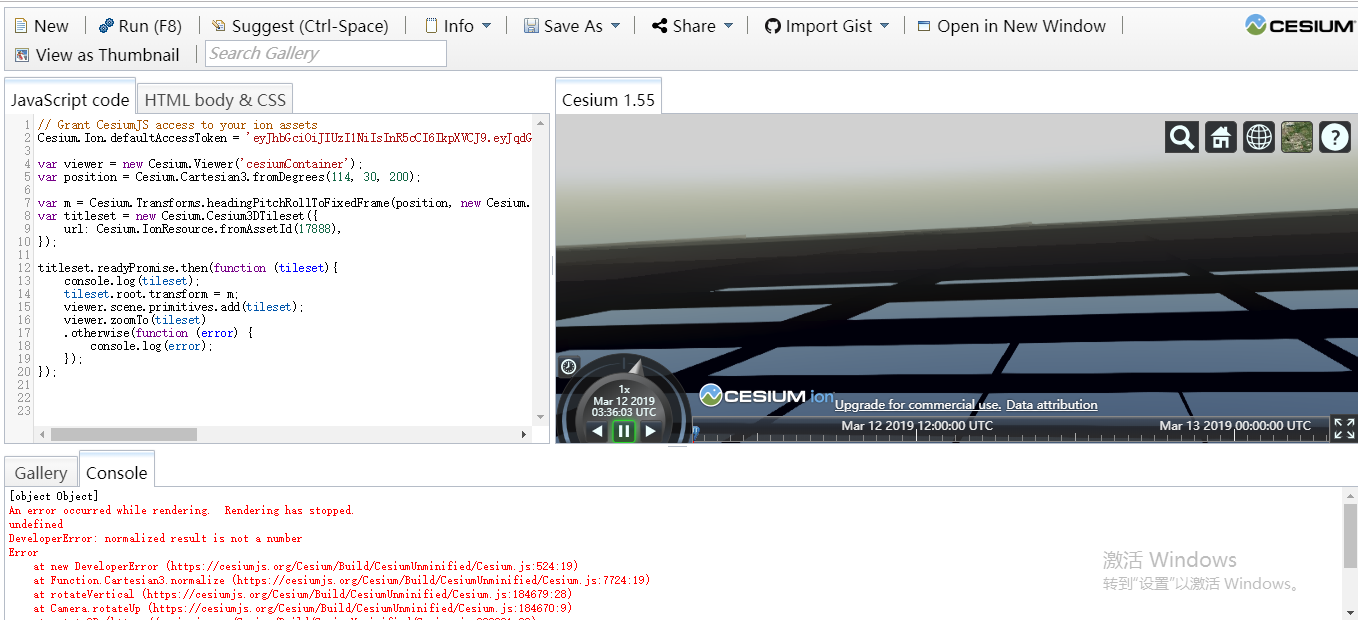

I posted my point cloud on CesiumIon. This is the link address. I will get this error when I use the mouse. The probability of this error is small.
My actions are zooming in, zooming out, panning and rotating. I have been using the mouse to perform these operations. At some point this error will occur.
