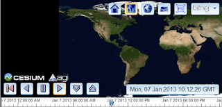

I need to limit the border of the 2D view map with the window. I want to fix the map when I zoom or drag.
The image shows what I do NOT want:
How can I do it?
How can I do it?

I don’t want to see the black background, so I don’t want to be able to drag the map like it:
