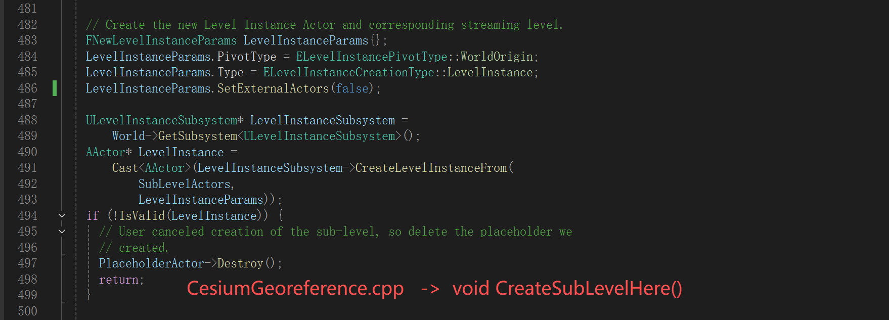

How to create the LevelInstance in the runtime? I want to load the .pak file and create the ALevelInstance as a sublevel.It can be created in editor mode.I have reviewed the relevant code. Is there any solution that can be implemented

I did encounter some trouble because the ‘LevelInstanceSubsystem ->CreateLevelInstanceFrom()’ function can only be used in editor mode. I also cannot use ‘ULevelStreamingDynamic’ because it cannot be converted to ALevelInstance. Do you have any way to dynamically create ALevelInstance in runtime mode and specify which level file to use. In this way, the UCesiumSubLevelSwitcherCompoonent component can be used to dynamically switch between sub levels.
