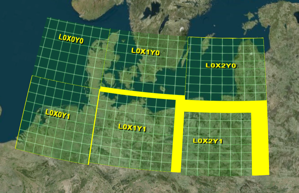

I found that and have got everything working with https://epsg.io/25832 except for everything is offsetet with 100km
That was with adding proj4 support and implementing a MapProjection(string:epsg) class that used proj4 to do project/unproject.
I am in the process of looking into how TilingSchema uses its tilexy functions to remap tiles to the globe and if this fails I will fall back to reprojecting on the server.
I succeded in getting it working on the client, https://twitter.com/pksorensen/status/636860539440918528, but as seen there are a few artifacts. Need to figure out where exactly this happens since there should not be much difference from this and google/bing tiles.
Anyone who can confirm that there is done nothing special for the epsg:3857 projection in the core of cesium and all logic is handled in the MapProjeciton and TilingSchema, then I know that the issue can be solved outside the cesium core.
Just for reference, the tiling schema I got working is documented here: http://kortforsyningen.dk/sites/default/files/old_gst/PDF/tiling44.pdf
also here is the current code I am using to do so. https://gist.github.com/s093294/253954c11ca3a48859fb
not much changed from original code of cesium.
Here is a code snippet that can be copy pasted into sandcastle to show the issue also.
https://gist.github.com/s093294/8ee1afd8253ba8f30b48
