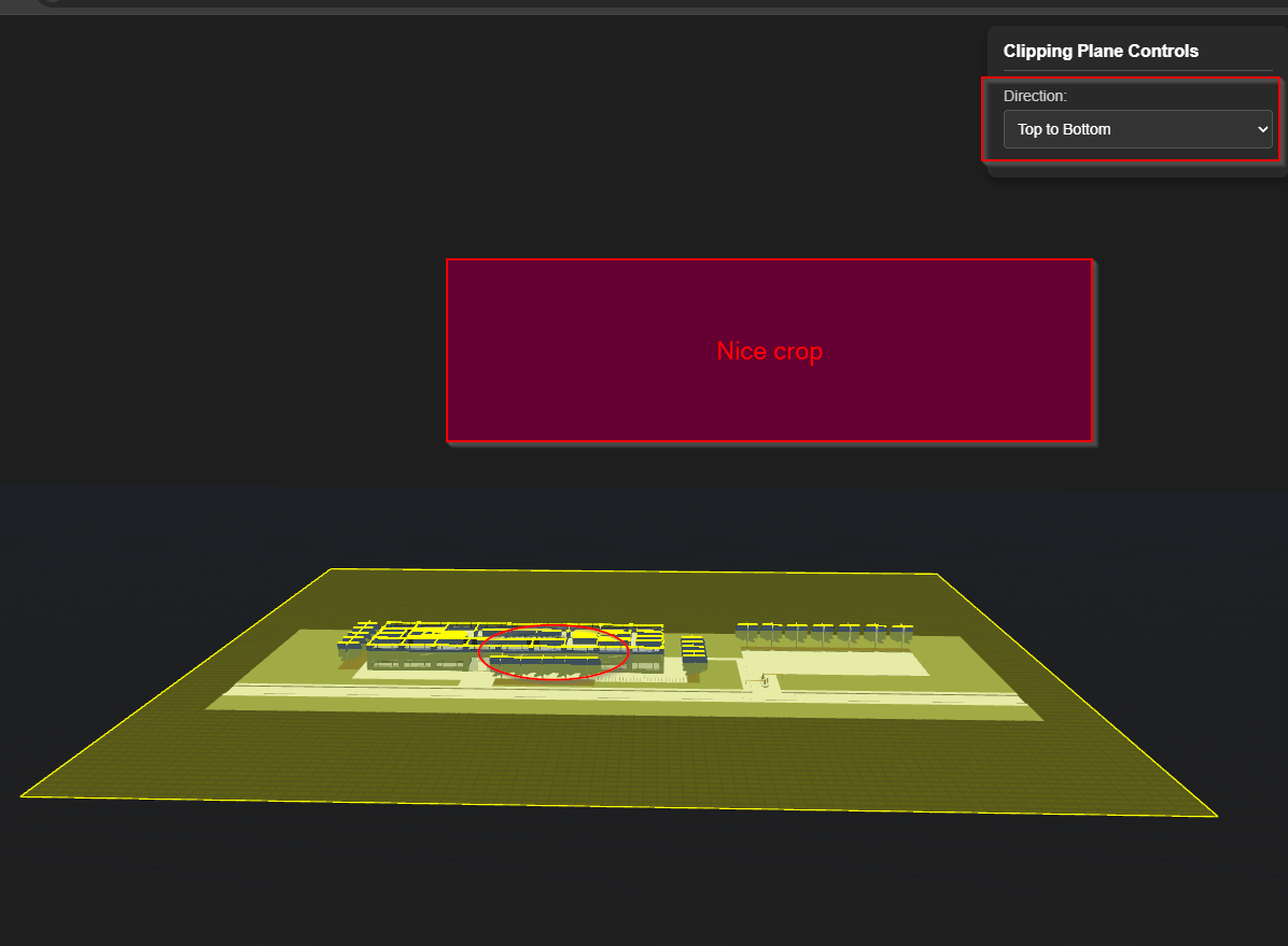

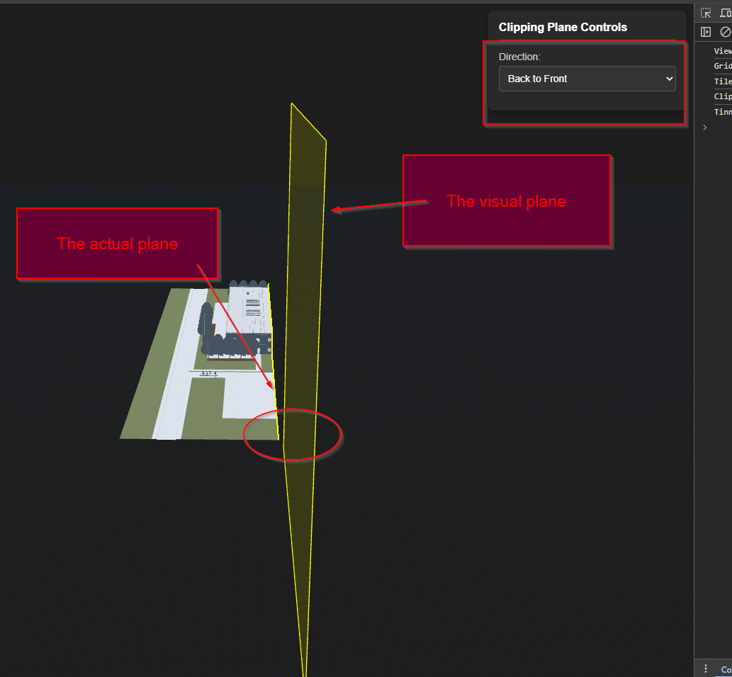

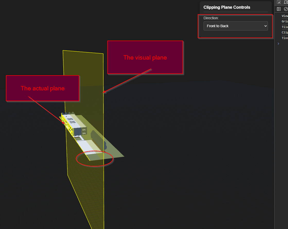

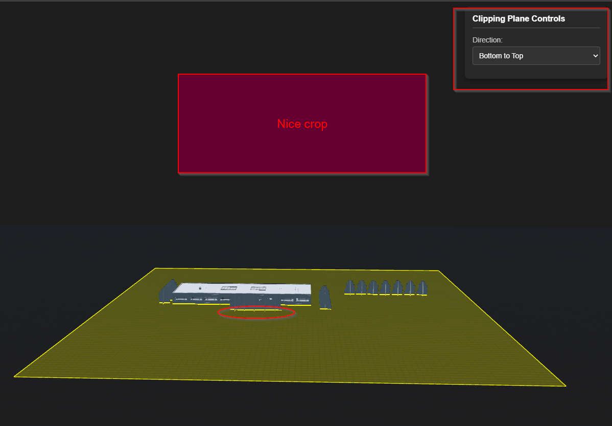

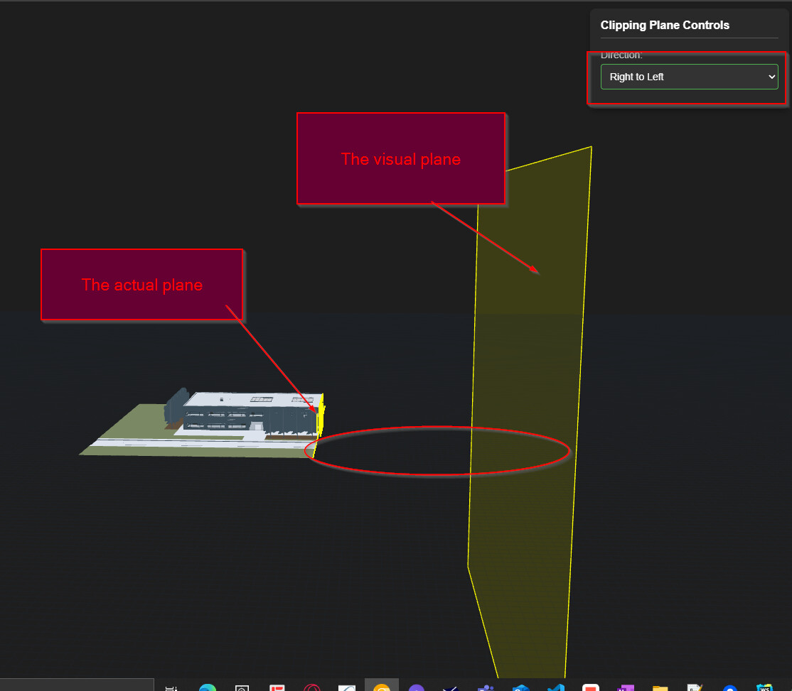

Thank you for your insights! The sample indeed cropped nicely, and I appreciate your input. Upon investigating the issue further, I realized the cropping failure isn’t in the vertical direction. To better understand and address this, I created a small public sample, added it to a GitHub repository, and published it as a GitHub Pages site. The repository includes all resources, including the model before and after Cesium conversion.
Repository: GitHub - valtingojer/cesium-clipping-plane: This project demonstrates clipping plane issues when clipping horizontal and depth
Page: Cesium Clipping Plane Demo
In this sample, you’ll notice that the vertical crop fits perfectly. However, the horizontal and depth directions don’t align as expected. The sample demonstrates the behavior in the following directions:
TopToBottom
BottomToTop
LeftToRight
RightToLeft
FrontToBack
BackToFront
What I found particularly intriguing is that the vertical crop works flawlessly, while the other directions don’t. Interestingly, when testing with other models, I noticed some deviation in the vertical direction as well in one case. This suggests the issue might affect all directions, but in this particular model, the vertical problem isn’t noticeable.
Could this be related to something I’m setting up incorrectly? I’d greatly appreciate any guidance or suggestions you might have!
Below, I’ve attached some screenshots for reference.
