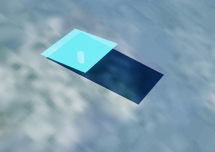

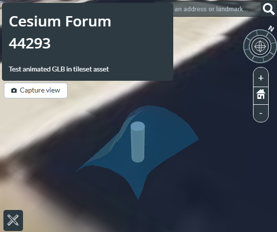

In theory, that works. And largely it also works in practice: You can load that tileset in isolation (in a standalone sandcastle). And you can press the :play_button: at the bottom (in the time control panel) to start the animation. And you can embed the tileset in a story. And once the tileset has been geolocated, you can apparently even edit that geolocation in stories (for whatever reason)…
But… it looks like it is not possible to start the animation inside a story.
@Ankit_Trehan Can you confirm that the animation can not be started in a story?
(And maybe even suggest workarounds…?)

When I tried uploading the foutainLocated.zip created by Marco13 as a “3D Tile,” the first frame of the bone animation was applied within the Cesium Ion Story.
