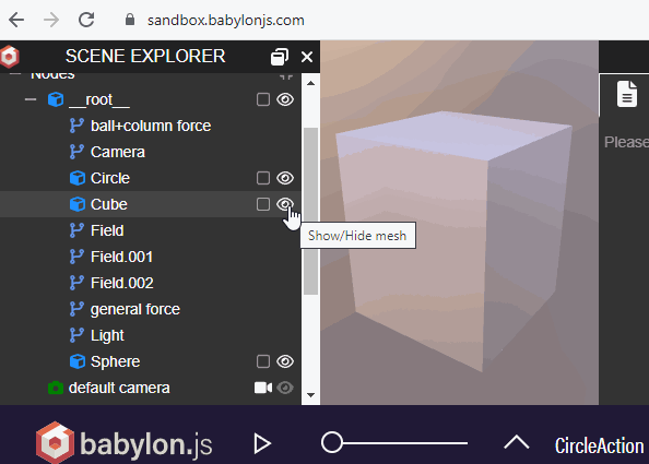

The GLB file itself does contain a cube - and this cube is so large that it encloses the animated part:
Cesium Animation Forum
The animation here seems to only consist of some disc-shaped object becoming larger. I had a short look at the result of importing that GLB into Blender, and … it looks like the original Blender scene might contain elements that cannot sensibly be exported to glTF (this could be things like particle systems or certain forms of volumetric (voxel?) objects). But that’s a guess until now - maybe it’s possible to analyze that further.
The cube is the domain in blender for the smoke and fire. The disc and sphere are the emitters. I do believe the smoke and fire from the sphere and just smoke from the disc are volumes. Any way I can get that to work in cesium?
This may confirm my guess: If this is created with a sophisticated functionality like ā€˜volumetric smoke’ or things like particle systems in Blender, then this cannot be stored as a glTF asset. One could be sure if you shared the original .blend file, but for now, it looks like this was the case.
More generally, it’s unlikely that something like this can be exported into a file format that can directly be rendered in CesiumJS: As far as I know, there is no standardized format that can describe these complex structures (like emitters, particle physics etc, smoke density) generically - and even if there was, supporting such a format is probably not in the primary scope of CesiumJS.
