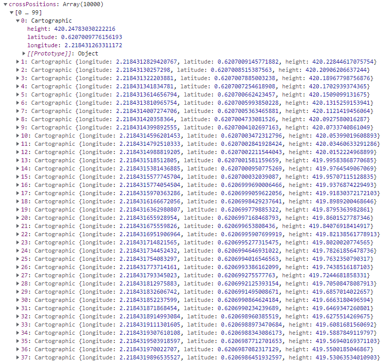

This is the cross positions information you mentioned! Thank you for your interest!
Additionally, before executing the “sampleTerrainMostDetailed” function, the height values in the array are sequentially reduced.
After executing the “sampleTerrainMostDetailed” function, it appears to be converted to the height of the 3D tile.
Please keep that in mind!
