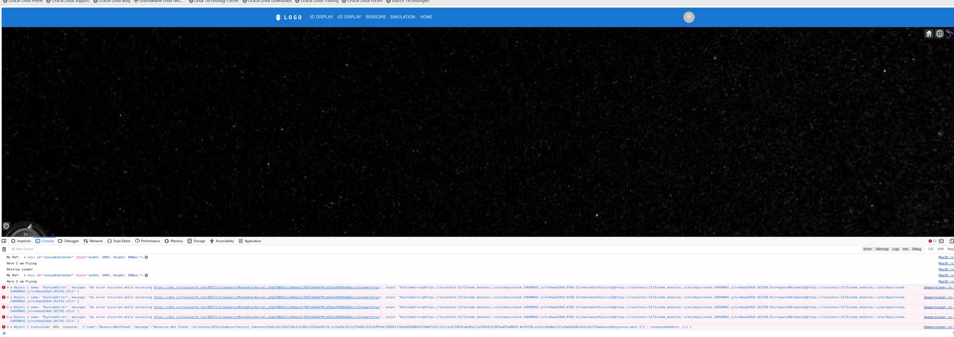

I’ve found some online information relative to how to run Cesium in my React App. It seems simple, yet I get an error message that says
The console suggests that the failure is in the download of the JSON performed as part of the image layer access.
The basic cesium app is running as seen by the controls:

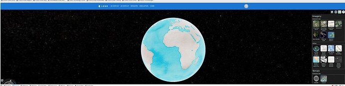

I’ve got the last little bit working. I had to specify a base layer.
                baseLayer: new Cesium.ImageryLayer(new Cesium.OpenStreetMapImageryProvider({
                    url: "https://tile.openstreetmap.org/"
I think I am good for now.

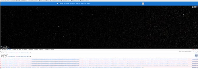

I’m still seeing the following errors, and I cant seem to see the circle of the earth consistently. When I type in the search box, the search box auto-completes the name properly, but the map doesnt zoom to that location (visibly).

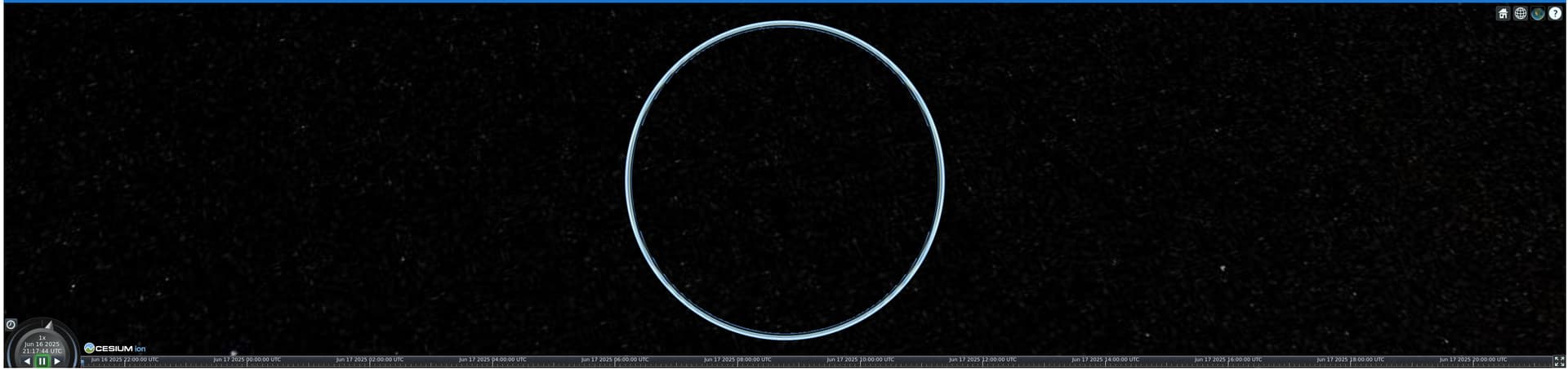

The end result is that I no longer get that error, and I can see the shape of the globe.
