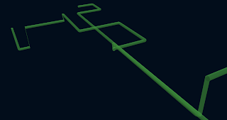

Display error polylineVolume when line from gorizontally to vertical
Good day. I have a question. I draw a polylineVolume and when line is vertical then shape be wrong. How i can put shape that polyline draw correctly.

Hello,
The polyline volume currently does not support vertical lines. I’m working on changing that in addition to fixing other bugs in the geometry, so it should be available soon.

Is there any activity about this vertical oriented polylineVolume issue ?
A workaround suggestion ? It would be easy to replace vertical segment with cylinder but then we need elbows at the cylinder ends…
Dana subota, 12. ožujka 2016. u 07:40:21 UTC+1, korisnik belousov...@gmail.com napisao je:
Since geometries like polylineVolume are designed to conform to the surface of the ellipsoid, we see some problems with “vertical” geometries. We’ve started some work on geometries that don’t conform to the ellipsoid, like in this PR, so keep your eye out.
In the meantime, I would suggest the cylinder. You could add additional geometries like ellipsoids to mock the “elbow” joints.

Try the function below which transform Three.js geometry to Cesium geometry. And use THREE.TubeGeometry with THREE.CatmullRomCurve3 instead of Cesium.PolylineVolumeGeometry.
