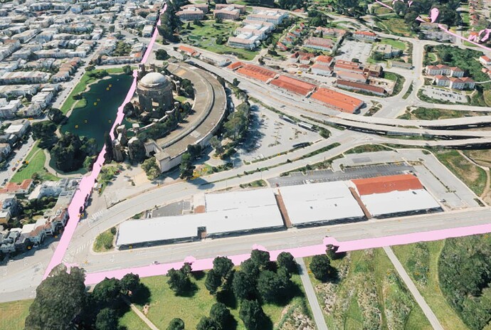

Appreciate geojson support is new and I can imagine two overlays might not be happy together as I’m indeed seeing, but thought I’d ask just in case I am doing something wrong.
So on a Google 3d tileset, all good:

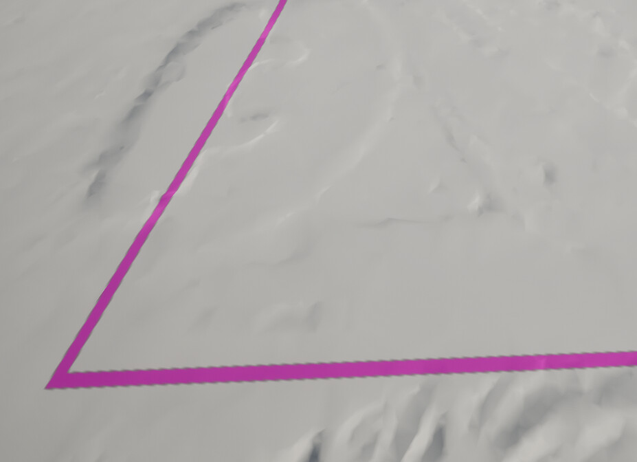

But on a Bing terrain with a Bing Ion raster overlay - it’ll have a grey background, occluding the bing overlay (and sometimes z-fight with it)

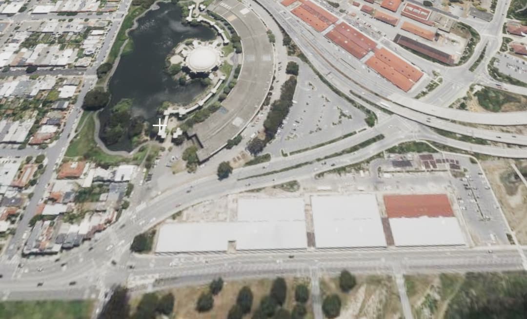

Bing overlay definitely texturing ok if I remove the Geojson overlay, or set it to use an Asset Id that doesn’t exist:

change default material layer key increase it by 1.
Ah yeah. Thanks. All good now.
