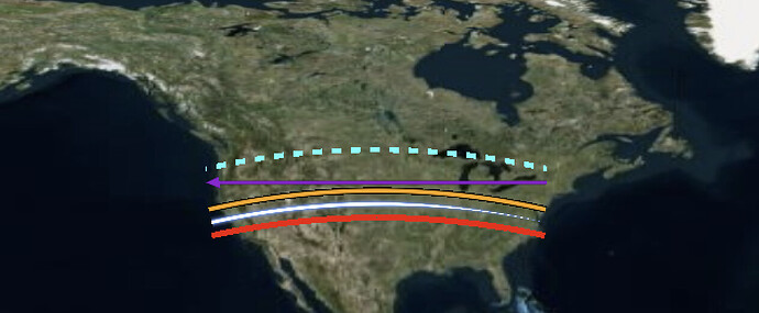

Hi @Itay_ba,
Thank you for your question! I suspect that you could use the Ray class here. Alternatively, a CZML polyline might be the easiest solution. I recommend checking out this sandcastle demo for more information on how to use CZML polylines.
As we can see, they appear in 3D and 2D.
