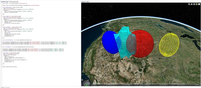

I also tried this in an older version of firefox (v135.0) and older version of cesium 1.124.0. Here is a screenshot showing 3 static ellipsoids that look normal and then one using sampled properties for both position and radii that breaks. Sandcastle link
Weirdly specific, but we have narrowed the problem down to a specific laptop… Any of my colleagues with Dell XPS 16 9640’s see the ellipsoid above, but other colleagues that have Dell XPS 15 9530 the ellipsoid looks correct.
