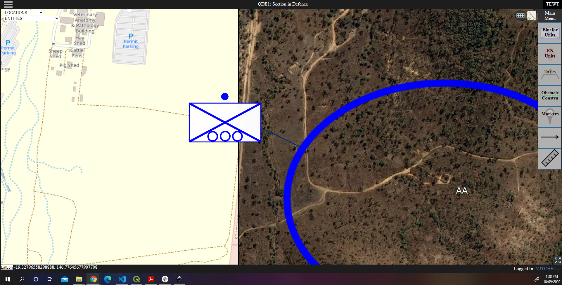

I display image icons on a map using entity.rectangle. I need the images to be draped over terrain or Ellipsoid.
There seems to be an area, that when i try to put a rectangle down, don’t appear and it is the only area it has ever happened to me - very strange. Further to that, it only disappears when in 2D AND ellipsoid. As soon as i change it to 3d or use terrain they reappear.
My work around was to set the height: 0 which worked kind of for 2D, which is the main view i use, but the images looked darker, like it had an overlay, and when i used Terrain, they would disappear.
Any help would be greatly appreciated
Location: Lat -19.339043098639443, Lon 146.7942235953388
Also when height is not set to 0, the select box sits up in the air.
This shows when height is set normal material
This is the same with height: 0
And when i remove heigh, and set to 2D AND Ellipsoid
