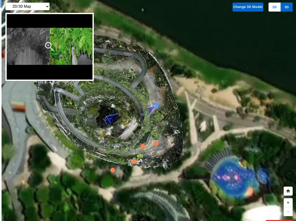

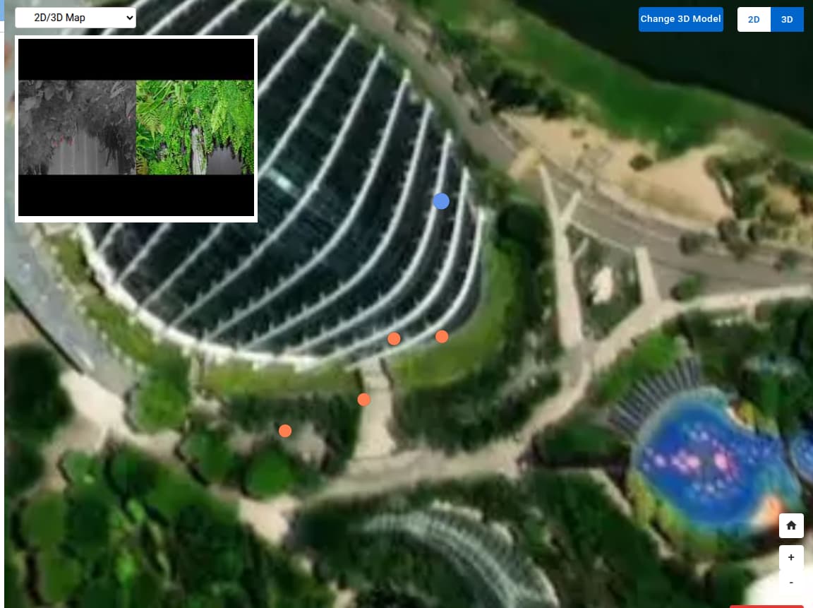

Frustum Geometry working with Craco but not with Vite, Please Guide if someone has faced same situation?
Above one is Craco Image
Above one is Vite Image

I figured out this , @jjspace problem arises when i upload 3D Tileset but its not rendering the map in 3D view , dont know if cesium need specific config with vite while i have shared my configs with you … Sharing you pictures where on Craco is rendering 3D map with tileset while vite not with same tileset.
@Zahid_Khan the only configuration that I know is needed for Vite is what is shown in our vite example. The vite-plugin-cesium library is not created or maintained by us. I’m not familiar with what it’s doing so there’s a chance it’s modifying the build somehow?
I’m not as well versed in the other parts of your config to suggest anything else for certain. The server + proxy sticks out as a possibility of not letting it load the data correctly depending how you’re fetching it.
Are you getting any errors in the app? I would not expect it to just not render without some errors or failed network requests. It’s possible it’s a cesium bug but since it works with the CRACO configuration I suspect it’s something int he build process.
