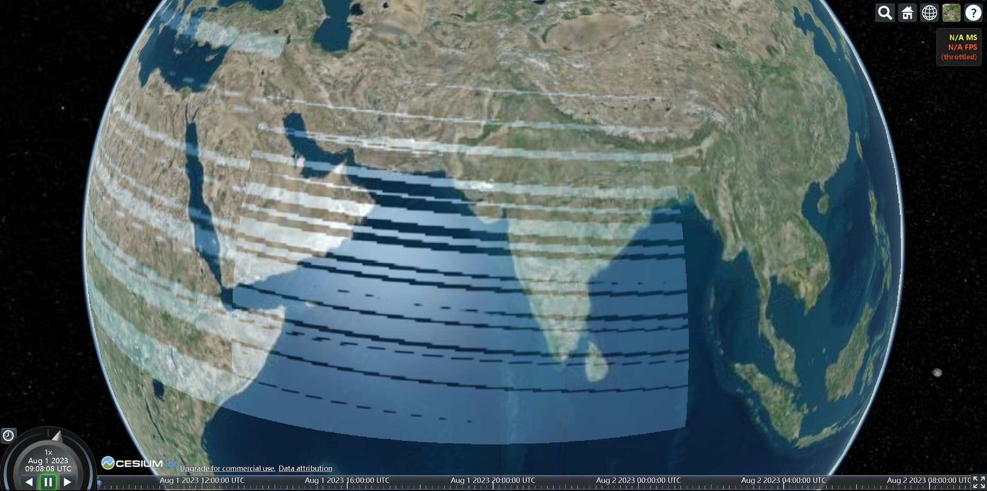

I have no idea about the Resource already being fetched error. However I did find out that if I set the d_resource.request in code snipet above back to request, the Resource already being fetched error would be gone, but Cesium would have some weired behavior. The world terrain else where are loaded correctly, but the region of my custom terrain is a bit spiky:
There are some stripes made of dynamic water texture on earth:
And my custom terrain would also fail to load. Not a single request was sent to the url.
