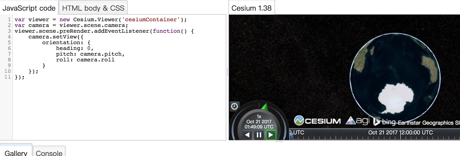

It does not seem to work. I can also rotate the global anywhere

@Onkel Tem have you found any solution of the problem? thank
在 2017年1月13日星期五 UTC+8上午10:13:46,Onkel Tem写道:
No ![]()
