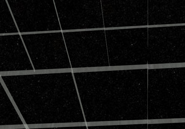

Hi, sean! I read the recent article on the underground display;Then I also made the appropriate changes to the source code, When looking up, there will be a very right border,How do I hide it?
在 2017年12月6日星期三 UTC+8上午8:00:16,Sean Lilley写道:
Just to be sure, is that an image looking at the underside of terrain or 3D Tiles?
If it’s terrain you can disable the skirts by following the steps here: https://groups.google.com/forum/#!topic/cesium-dev/t6u86rcpN4o
