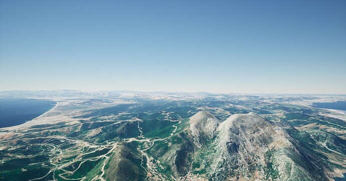

    I’m not sure what you mean by this as, to my eye, the terrain in Morocco is very much not flat in Cesium World Terrain:
