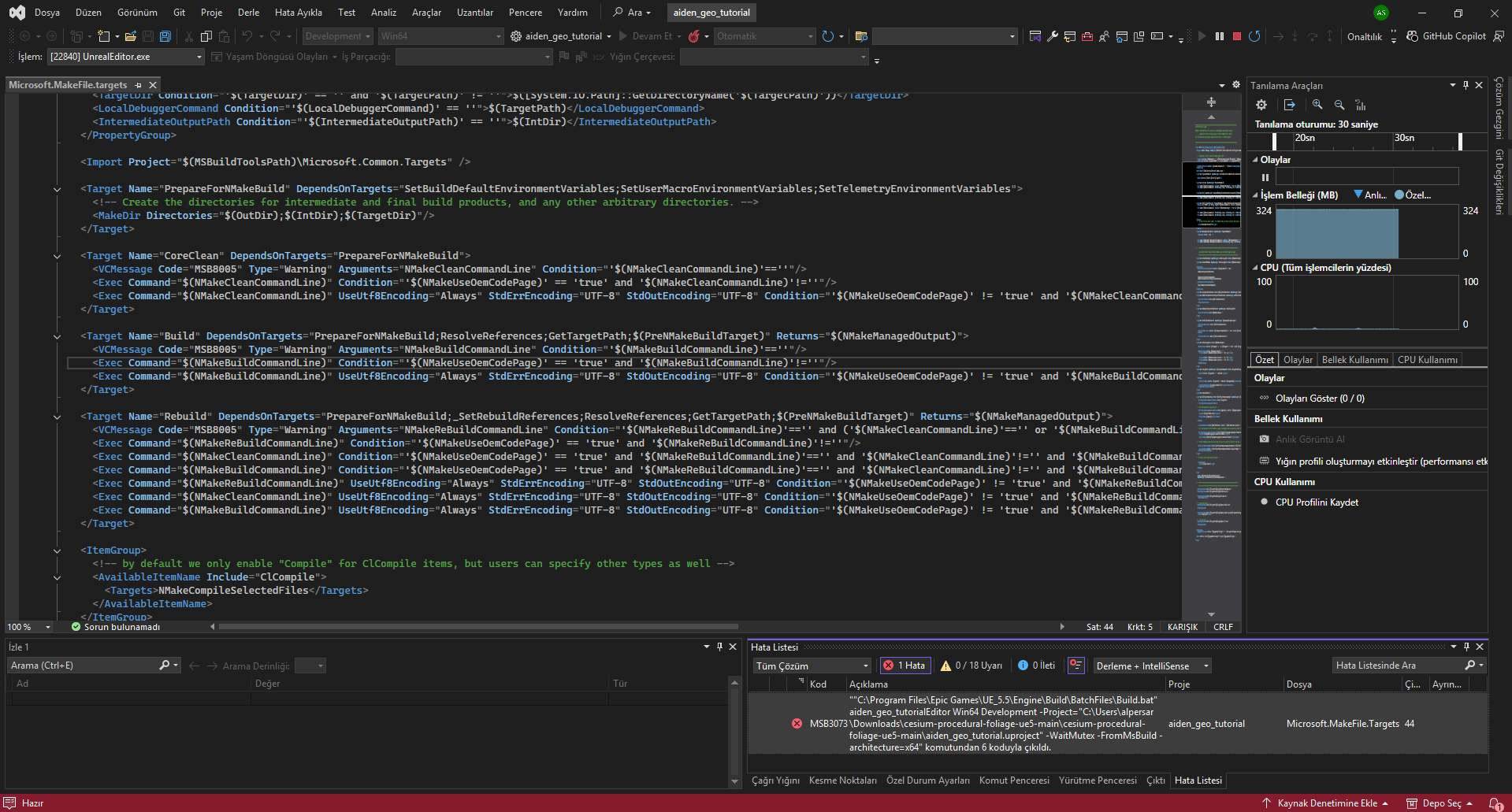

this is the visual stido screen when i follow the instructions to open project
Might be a long shot, but have you regenerated the source files via the uproject? i get this quite alot when the plugin i’ve made has underlying issues/corrupted build state.
Edit: Testing the Repo on my 5.5 now. Same Errors, there’s a few things skipped; slowly going through them.

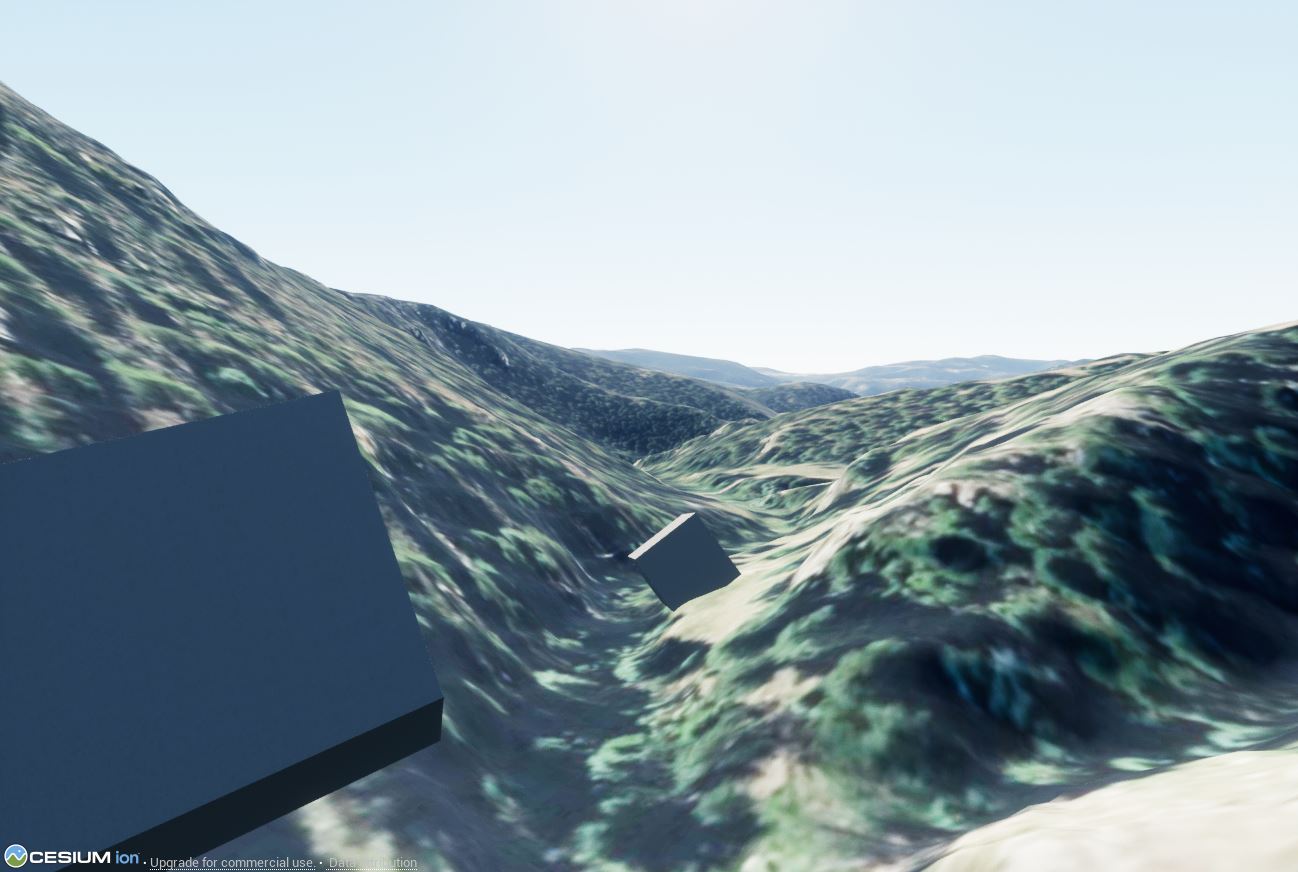

Update 4: Need to fix a few more things, project runs etc, but the foliage is blocks (set in details panel) and it’s just kind of floating.

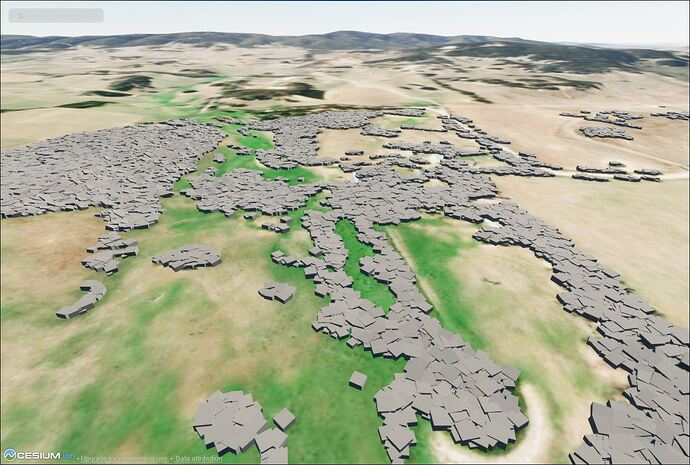

Okay, fixed quite a lot of performance issues, the system kept locking up for 10-15min at a time when using ray-casting (non ray-casting just wouldn’t work). You can now fly around and it’ll spawn blocks etc, with minimal hitches. Still some weird quirks, as in, if i use 1024 for a capture elevation, it seems to work okay, and you get some hitting the ground, some in the air, but any other number set for the capture elevation seems to result in no trees/blocks.
Managed to get some trees on the ground, there’s still random floating trees (cubes atm).
We’re getting closer, ill keep working away at it, hopefully can get some consistent results as the z-offset on the foliage seems to play a huge part in the puzzle (even when the distance to ground has been calculated via ray-casting).
