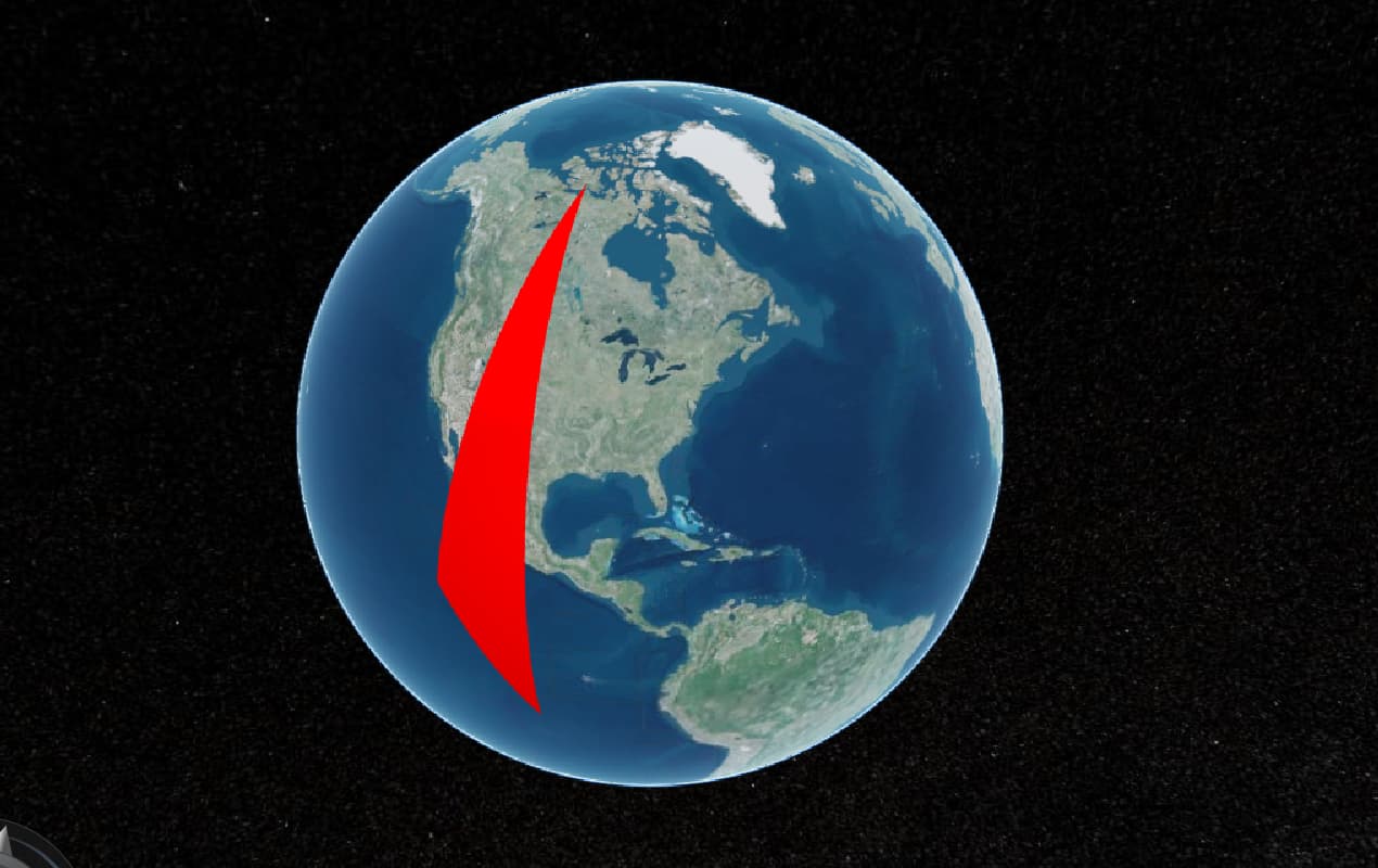

Description: As in the Demo, small polygon could render per 50ms and 100ms, large polygon could render per 100ms, but could not render per 100ms. I think it is because rendering large polygon has lower performance. Any solution to improve it?
small polygon:
large polygon:

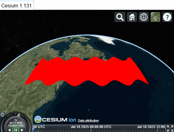

Yeah: Use some of the classes of CesiumJS in a very specific way. Since this is a pretty common task, I summarized that in a utility function. That function receives an array of positions (as Cartesian3
objects), and returns an ‘entity’ - a polygon that can be rendered.
Modifications of the positions will change the shape of the polygon. In the demo sandcastle, this looks like this:
The actual positions in this example are just some ~“animated sine-wave”. But the point is: You can fill and modify this array with any data (even with many points and large polygons), and CesiumJS will take care of rendering them.
Here’s the sandcastle:
