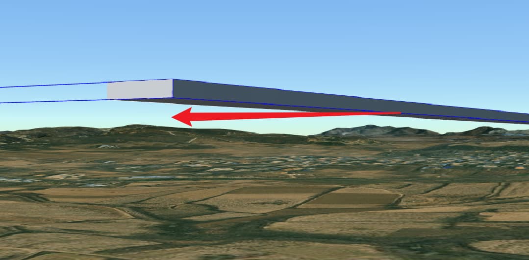

I am loading a long-distance road, but both ends cannot align with the Earth’s surface. What should I do to handle this? the road is based on WGS84 Coordinate System.
Here is my tileset.json:

snapshot:
I think you need to georeference(modify the modelMatrix of your tileset) accurately your tileset.
Or you need to load your custom terrain that fit with your road.
