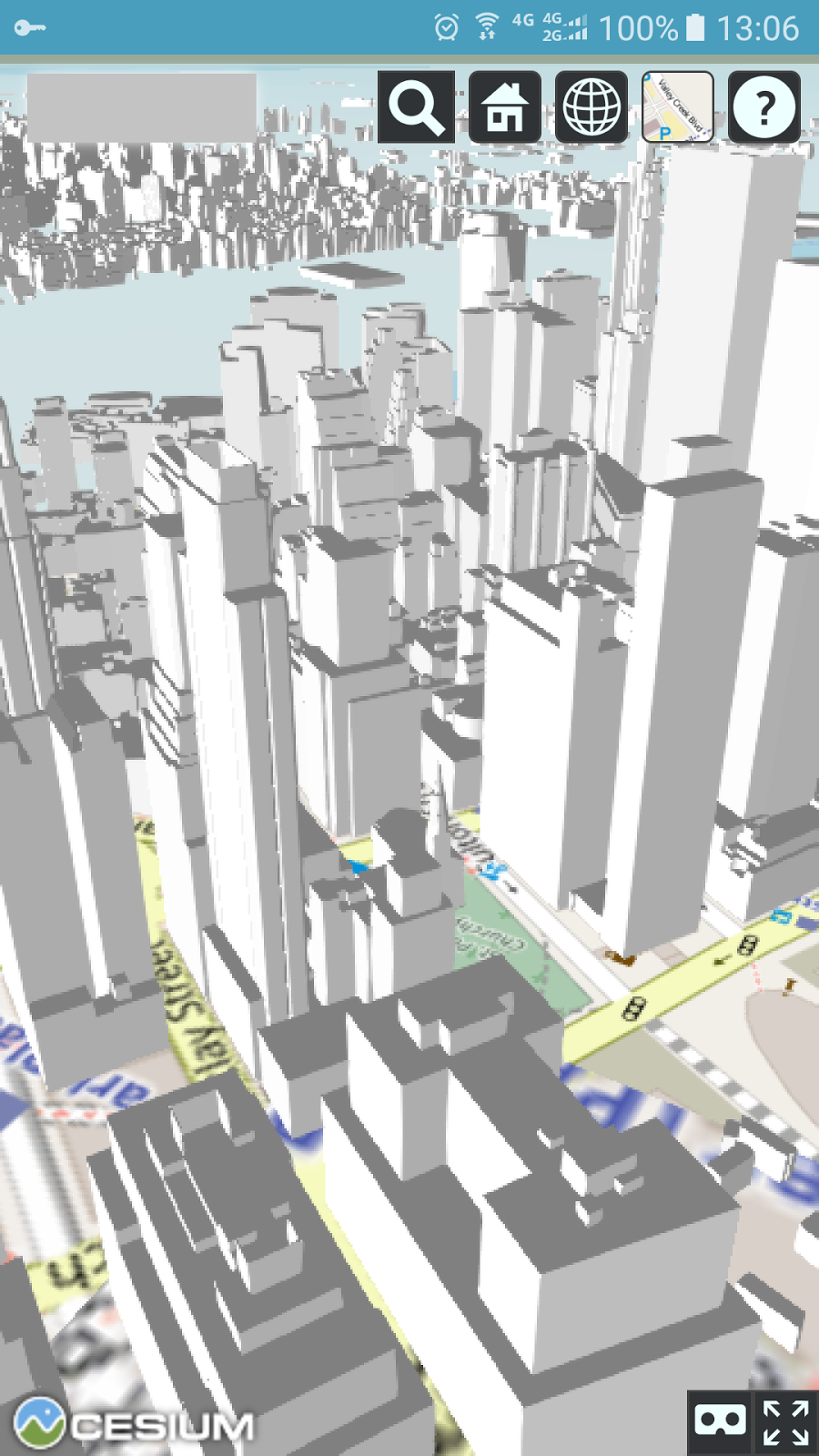

I build a Cordova-based Cesium app in android.
But the resolution is low and I can see pixels in the screen.
The resolution of my device is 1920×1080.
Is there any way to display high resolution scene?

You can try setting viewer.resolutionScale to window.devicePixelRatio. From CHANGES.md for 1.18:
* Cesium now honors `window.devicePixelRatio` on browsers that support the CSS `imageRendering` attribute. This greatly improves performance on mobile devices and high DPI displays by rendering at the browser-recommended resolution. This also reduces bandwidth usage and increases battery life in these cases. To enable the previous behavior, use the following code:
```javascript
if(Cesium.FeatureDetection.supportsImageRenderingPixelated()){
viewer.resolutionScale = window.devicePixelRatio;
Thanks Sean
It works perfectly.
