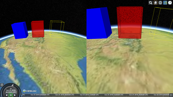

1. i am doing multiCamera mode,this frame render normaly,but next frame,first i will change camera(i create it for another angle/view/direction to look )and i will render the texture to RBO(i make a new fbo and new a Renderbuffer to be a colorAttachment ) when scene._fxaa.excute, and readPixels to create a IamgeData ,and call another 2d canvas's gl(WebGLContext2D).putIamgeDate() to display the another camera's picture.
now,the z-fight appear in another canvas in translucent box and skybox,i don't know how to upload picture to show the sittuation. only word? who can tell me?
