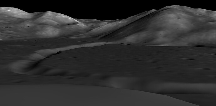

Apollo 15 landing site area

For comparison, I captured a screen shot viewing the same approximately location from the Apollo 15 landing site you shared above:
And @semeion here is a overview of the Apollo15 landing site in the CesiumJS sandcastle
Thanks again for bringing this to our attention!!
