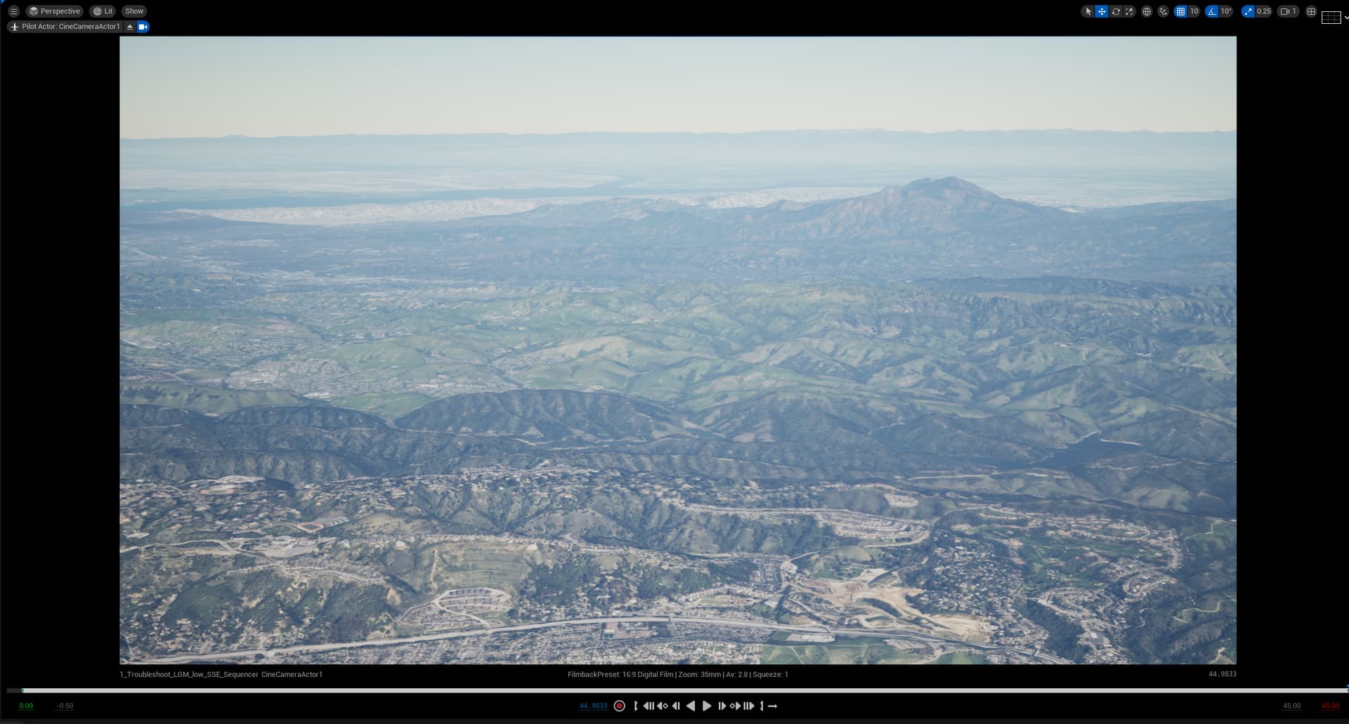

  8. Keyframe CineCameraActor1:Transform @ 0 and 45s (shown below) to create a zoom out effect

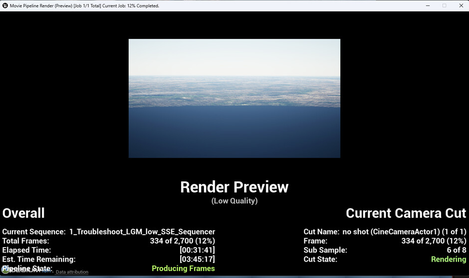

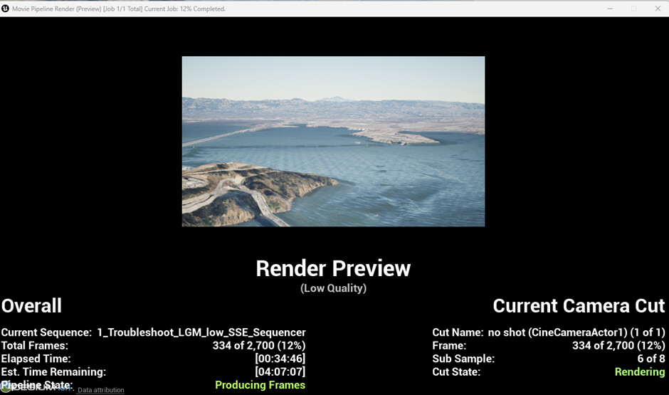

The second and third times were repeat runs at low SSE (=1) for Cesium World Terrain - as you mentioned above it took a while to begin (15-20 min) but then both times it froze on frame 334/2700

(note the difference in “Elapsed Time”)
To make sure, I left the third run for two hours and it did not resume (very consistent with the freeze I’ve been getting in my other projects)
